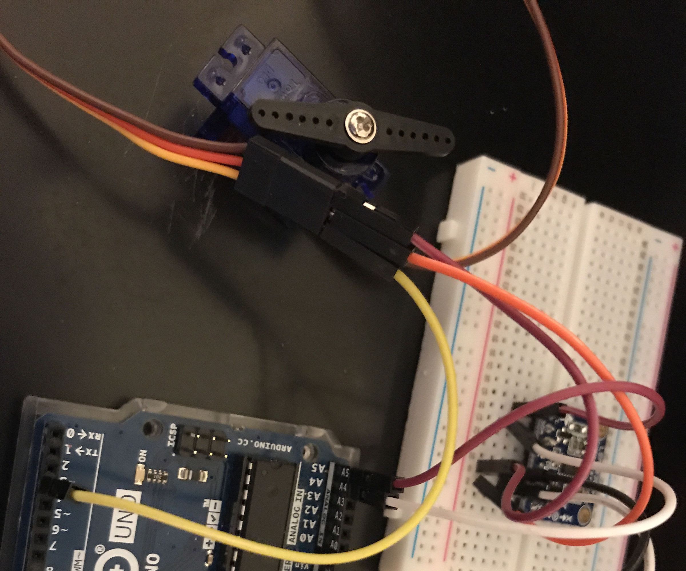

Step 10: Arranging Sensors
Now you have to arrange everything on a breadboard before you can move it to a PCB board, then decide how to arrange it on the PCB. You can do it however you want; here's two different examples and schematics to help.
If everything is hooked up correctly, the buzzer and the light will both activate when the thermometer detects a temperature higher than your set temperature. If it does not, a blue light will slowly flash instead.

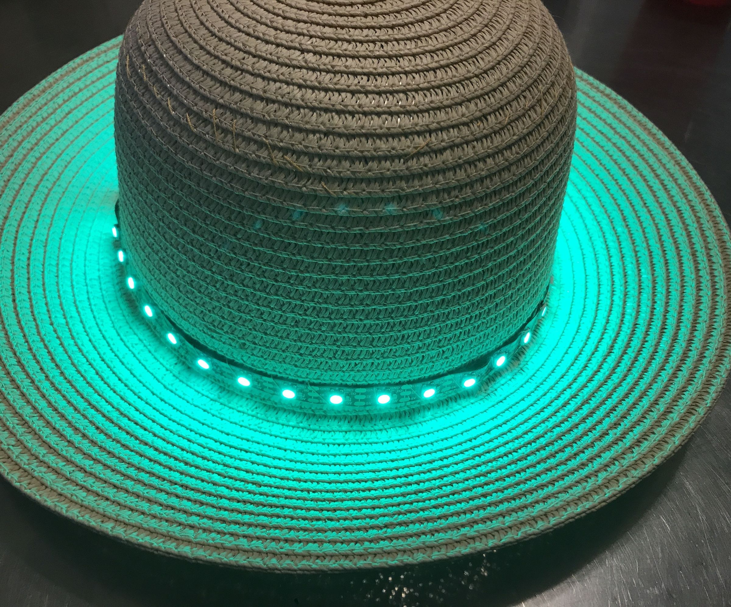

Step 12: It's Done, You Decide Where It Goes!
By now, you should have everything completed. At this point, it's up to you to decide where you put your device. For the example, I'm using a 5 volt battery, but long term, you'll want a stronger source of power if you choose to use a large amount of LEDs.
I plan on putting it in a hat, as an example, but you're free to do what you like with your own.
