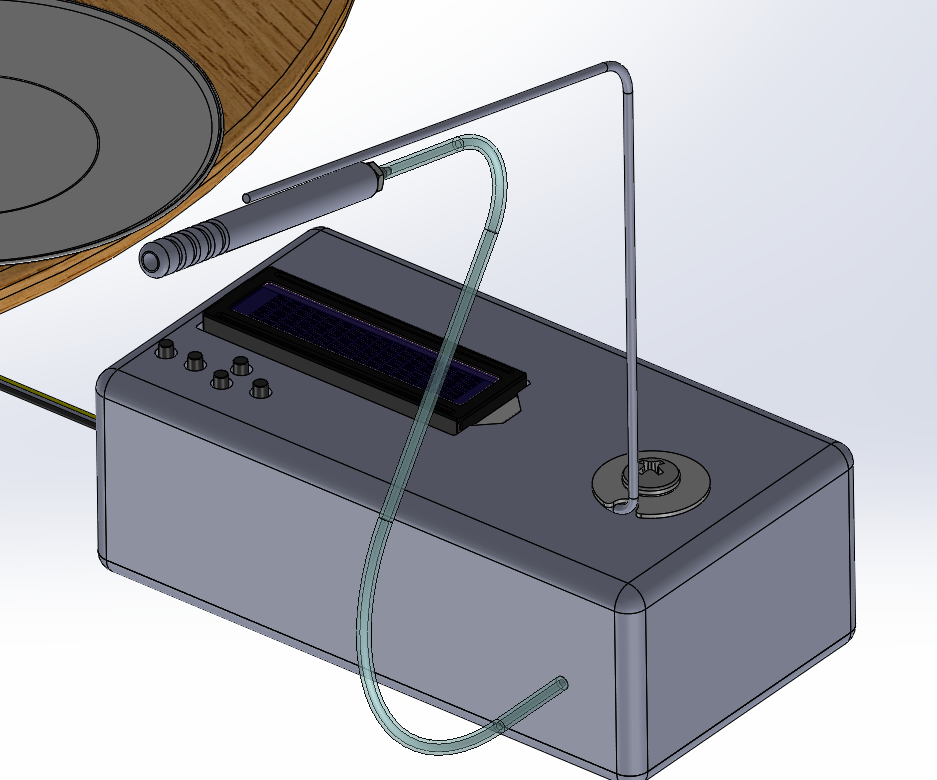

Step 4: THE MOUTHPIECE
The Mouthpiece may be the only part of this design you actually need to fabricate yourself. I am sure there are other solutions out there, but I haven't found them and this will fit the 1/16 X 10-32 Barbed Tube Fitting utilized in this design.
Use just about any solid plastic type material for this part: Polycarbonate, Acrylic, Delrin, etc.
Start with a rod of approximately 3/8" Diameter and 2-1/4" in length. Put the rod in a lathe and drill a 0.159 hole all the way through it. Later, you will tap the one end with a 10-32 Bottoming Tap for the Barbed Fitting.
Cut some smooth grooves near the mouth end of the tube to enable the user to grip it with their lips and teeth. Polish it up while still in the lathe with scouring pad material to remove all roughness and sharp edges.
