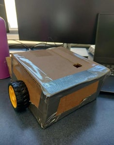

Our team ( Katherine, Adriana, Rodah) Created this instructable to show what we have learned from our ME 208 Course at the university of Kansas instructed by Dr. Wilson.

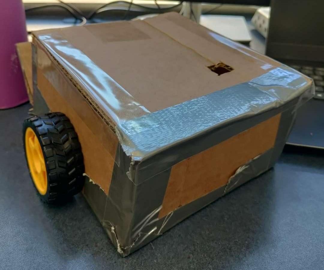

This robot uses a cardboard box as the body, everything inside is from Sparkfun tool kit. It also complies with the 4H robotics requirements for the Douglas County Fair. The difficulty of constructing the robot was not too difficult to put together. Understanding and building is the more difficult part but accomplishable.
The car can drive forward/backwards and stay within a specific perimeter. With the code functions we created to draw our piece of paper.
Time needed to build the drawing bot will only take a few hours.

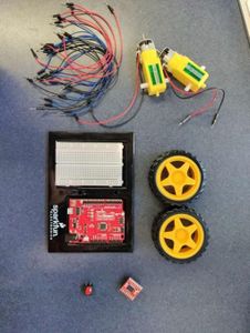

You will need the SparkFun inventors kit v4.1
Tools from kit;
·        1 Arduino Uno
·        1 Small Breadboard
·        1 Motor Driver
·        1 Button
·        1 Medium Cardboard Box
·        1 Marker
·        1 Large Sheet of Paper
·        2 Hobby Gearmotors
·        2 Wheels
·        15 Jumper Wires
·        1 Battery Pack
·        4 AA Batteries
