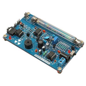

Step 1: Arduino Geiger Counter Kit
Couple words about Arduino Geiger counter kit. Main part is Geiger-Muller tube. Usually it is glass or metal cylinder which is filled up with inert gas: Argon, Neon, cathode and anode are applied to it. There is a thread inside the tube along as anode, if body of tube is metal one - it takes part as cathode, or applied to the ends.
Any way, above 300 - 400v potential should be applied to it. When high energy particle cross a tube with neon gas inside, it ionizes atoms and we have got a mixture of positive/negative particles. In the high energy electromagnetic field in the tube is being evoked avalanche of charged particles. So 1 hit particle means 1 movement (actually spark) to the cathode direction.
Our microcontroller in Arduino Geiger kit treat signal into digital one, and we read it off on the vin pin.

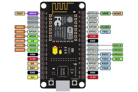

Step 2: ESP8266 Node Mcu
Main idea of this project was to write App, which could provide us with possibilities to depict radioactivity in graphically pleasant view. To achieve it I had to connect Arduino Geiger counter to Arduino board, treat information, pass and store data on cloud service. App has direct connection with Arduino via com ports USB or Bluetooth via hc-05 module. Also can get access via internet to our cloud to take stored data and treat it.
So, first worked project I decided to design with ESP8266 node mcu and arduino geiger kit.
Actually it was not very difficult, but I had encountered with some troubles and esp8266 particularity.
Mark it, pins on it are ordered in different way comparing with traditional Arduino boards. And not all pins are free and can treat information as we suppose.
Big disadvantage is that it has only 1 UART. If you think about diagram signs like rx1/tx1 so it does not work as you think. So if you planing to build some bigger project with lot of sensors keep it in mind

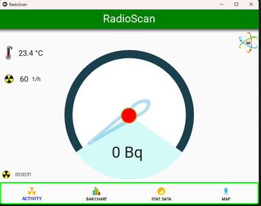

Step 3: RadioScan App
So I have written a frame of app in python kivy framework.
it is quite ease library to create cross platform application. Lots of python libraries allow us to run processes in different ways as we wish. You can combine everything.
I have used such libraries as kivy-garden, mathplotlib, pandas, pyserial and re. Main feature is to depict real time data
and get stored information from cloud. I set hardware part to pass data to web server, which posts data into web page on PHP server.
So, the App consist from 3 screens: graphic screen with momental information, which we get from Arduino board with pyserial library.
Second is actually that same, but with another view. We have real time plotting with appeared bar columns. As higher bars are, as intensive radiation is.
3d window give as possibilities to extract data from web cloud, choose date and observe measurements on that particular period.

About hardware. I have connected esp8266 to the Arduino Geiger kit, Bluetooth module hc 05 and dht 11. It was not so smoothly as it seams in the first view. I had troubles with pins. As I understood after, pins are in other order and not all of them work digital input and with interrupt events. So explore esp8266 pin out in detail before working with that.

Step 6: RadioScan 2.0
The App view basically is that same, except of adding of map screen. To do it, we have to use garden map view library.
