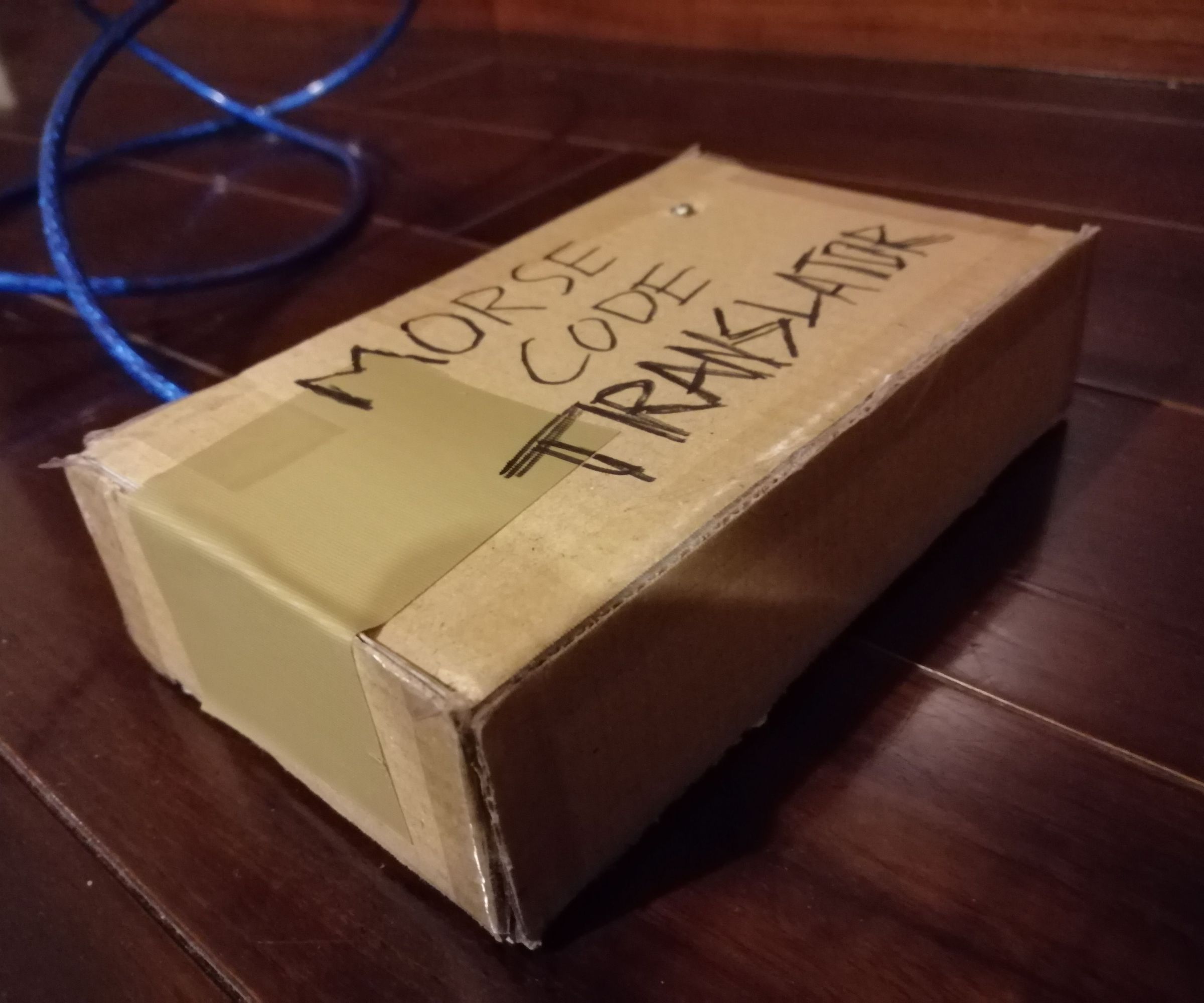

Step 5: Casing for Electronics
The casing for the electronics is basically one small box with a circular base and a long strip of paper for the numbers.
Small box
8cm x 2cm piece x2
14cm x 8cm piece x2
14cm x 2cm piece x2
Circle
11.46 radius circle
Number Face
72cm x 2cm piece of paper of soft cardboard. Write starting from 12:00 with 1 cm intervals until you reach 11:50, which the length of the paper should be just enough for all numbers to fit.
Base
Any size and shape as long as the clock can fit on it.
Note: Remember to cut small holes in the box (see images above) for power and LED lights. Also cut a hole in the circle for the rod in the middle.
Step 6: Assembly
Before sealing the box off, arrange all of the electronics made according to the image above. Tape or glue everything in place. Then seal off the box. Create a small rod out of cardboard to fit through the clock's hole and connect it to the rod of the stepper motor. If the clock is too heavy and is drooping, you could add support on the other side of the clock. It doesn't really matter how you do it, as long as you can stop the clock from leaning to one side, but the images above show how I did it. Then connect the whole clock to the base below and secure it with some tape and glue (see images above). And to make it even cooler, add an arrow on the box pointing at the numbers to show time more clearly.
