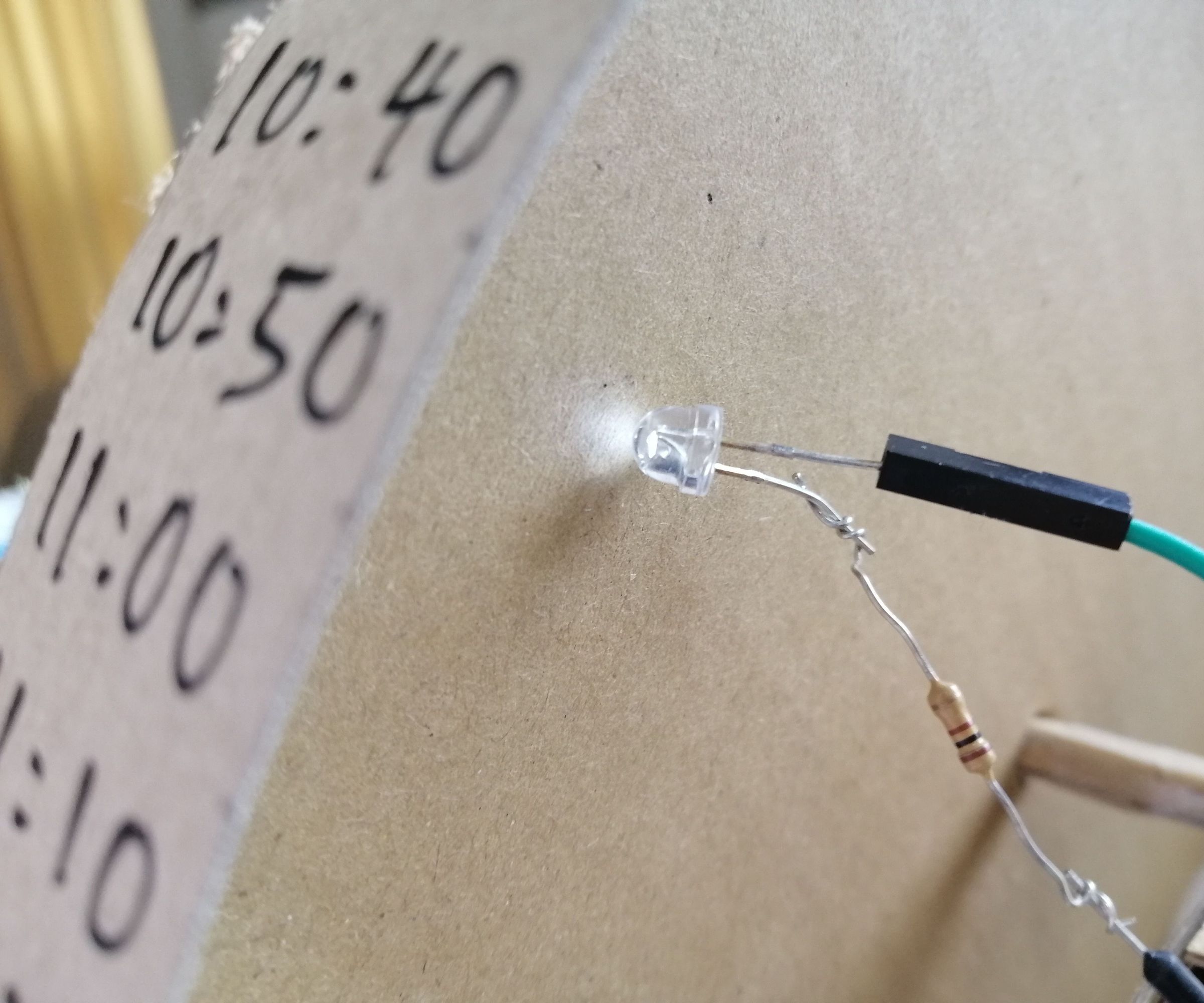

Step 1: Curcuit Assembly
When connecting the components to the Arduino board, you may use a breadboard, which makes the wire connections way easier. Or, if you want to make a more permanent and lasting project, consider welding the wires. As for me, I used some pliers to tangle the wires together to connect them. You won’t need to buy anything extra or know how to weld to do this. In addition, it saves space by removing the breadboard, allowing you to make the device even more compact if that’s what you’re going for. The only downside is that they aren’t as secure compared to the other methods. Also, be aware of the digital pins used in this project when assembling the components. The pin for the LED is 13 and the pin for the speaker is 5. Do not connect the wrong pins otherwise the code might not work for you. When connecting the LED, the positive and negative charges of the LED are important. One way to tell the charges is from the “legs” of the LED. The longer leg is the positive side, so connect that directly to pin 13. We can control the LED with the function digitalWrite(13, HIGH) and digitalWrite(13, LOW) to turn the LED on and off. For the shorter leg, connect it first to the resistor and then connect the resistor to a pin called GND. GND is the equivalent to the negative charge. For the speaker, the positive and negative sides should be marked with black and red wires, if not then often the brighter color is the positive and the darker color is negative. Connect the positive end to pin 5 so we can control it with our code, and the negative side to GND. Your board should have at least 2 GND pins, so there should be enough pins.

One last thing to do before sealing the board into the box is to test the code. Make sure the speaker and LED are working properly, and the serial monitor inputs are working as well. If you have any issues, comment below! Most common problems can be solved by compiling the code in Arduino IDE, as it catches most simple errors. To use the translator, you will need to key in the letters in FULL CAPS, and the spaces will need to be “_”. To use it, open the serial monitor and set the line ending into “Both NL and CR”. Type in the phrase and press enter to translate.
Step 5: Putting Everything Together
Once the software and hardware are set, you are ready to put everything together! Secure the board and speaker in the box, and put the LED through the hole you left in the box for it. After that seal the box and voila! You have your very own Morse Code Generator!
