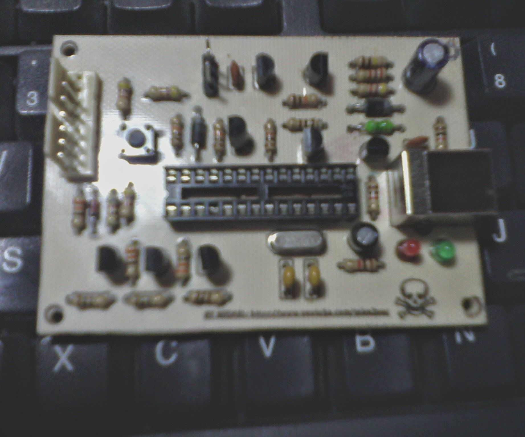

Step 3: Circuit, Schematic and Pcb
Here you can see how everything is connected in the schematic, I upload files made with EAGLE.
Hope you find it helpful, any questions or comments let him know, greetings.
