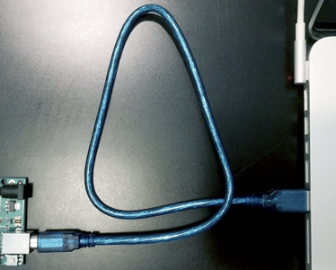

If you have not already done so, Connect a USB 2.0 type A/B cable into the Arduino. Next, connect the cable from your Arduino UNO into the USB port of your computer. If your computer only has USB-C, then use an adapter to convert USB to USB-C. After that, copy and paste the code below into the Arduino IDE. Next, click the arrow button in the Arduino IDE just to the right of the checkmark in the top left corner to upload the code.
