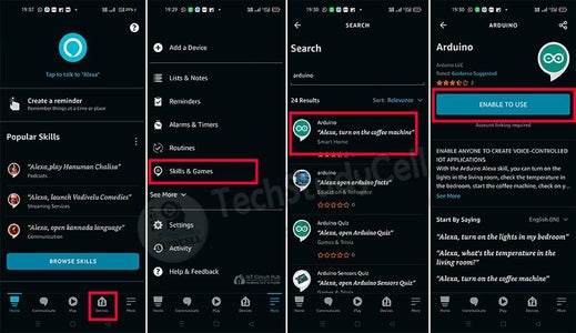

Step 16: Configure the Alexa App for Arduino IoT Cloud
Download and install the Amazon Alexa App from the Google play store or App Store.
  1. Tap on "More".
  2. Then select "Skills & Games".
  3. Search for Arduino and tap on "Arduino".
  4. Tap on "ENABLE TO USE".

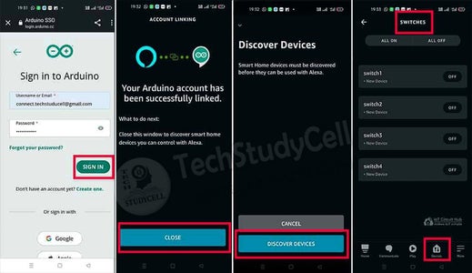

Step 17: Connecting Arduino Cloud Devices With Alexa
  1. Log in with the Arduino Cloud credentials.
  2. Tap on CLOSE.
  3. Tap on "DISCOVER DEVICES". It will take a minute to add devices. During this time the NodeMCU should be connected with the WiFi.
  4. Tap on "Devices", and tap on "Switches" to see all the devices.
Thus, all the devices from Arduino IoT Cloud will be added to Amazon Alexa App.
