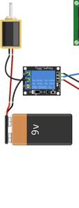

In this step you will now put everything together and upload the new code. After copying the schematic above, connect the Arduino board to your computer using the USB cable.
(NOTE: Picture 2 is a reference I used to connect the LED to the relay. I only copied the output connections from the relay to the LED and 9v battery.)
The green power LED (labelled PWR) should go on. Open the Arduino IDE and choose corresponding board type and port type for you project.
The following code will activate a 5V relay when the password is entered correctly, load it to your Arduino board.

The output pin that activates the relay is defined on line 7:
int signalPin = 12;
Step 4:
That's it! It should look a little like this.
Here are some additional photos that show the connection to the LED, Breadboard, Relay and 9v battery.
