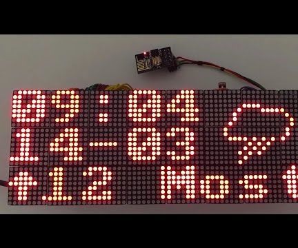

I've tested the whole idea on display that consist of 8 LED Modules in horizontal and 3 in vertical position. This gives us 24 modules which are containing 1536 LEDs (88 * 38).

First picture shows the physical display that I've used for testing and examples. Each LED Module has label indicating its position and Select Slave line.
