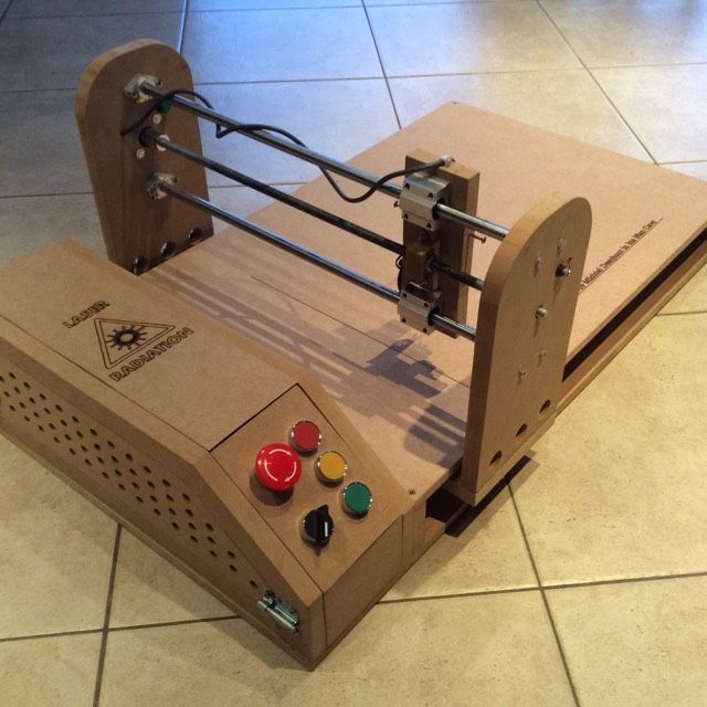

Step 2: Design
Well, It took me a lot of time before I came to this design, first I made a few others, but this one was truly the nicest design i've made (if i may :)). I have drawn all of the parts you need to make on my computer and I uploaded them somewhere in this step (go find them!). If there are missing a few dimensions on some of the drawings, it's because I will tell you later in this instructable or because it really doesn't matter :).
The whole machine is made of MDF sheets with a thickness of 18mm and 12mm.
I made this design also because it would be very easy to attach a Z-axis and a dremel rorary tool so you can convert it to a cnc router.

Step 4: Assemble Your Laser Engraver!
Now, you have all the parts you need to assemble it. The first thing I did here was mounting the door in the electronics case left side with a lock and a hinge (that's the easy part, so I did that first :p ). To assemble the electronics case I used a lot of those L-formed iron pieces with holes in it, I don't know what they're called in English but you'll know what I'm talking about when you see the pictures. If someone knows how to call them, please leave it in a comment, for now, I will just call them 'those things'.
UPDATE: Appearently these L-formed iron pieces with holes in it are called L-brackets. ;)
First, take again the left side of the electronics case and mount the front and the back of the electronics case on it with some of those things I talked about. I didn't use screws or nails to mount the top and the control panel, I just mounted some of those things again and laid the top and the control panel on those things, because when you want to put al the electronics in it, you won't have problems. Don't forget to mount some of those things to the right side of the electronics case, and mount it to the rest of the case.
Put the electronics case away for a second and take the base plate and the X-Axis shaft support pieces and mount them like you see I did in the pictures, make sure the X-Axis shaft + motor support is on the right side of the engraver. Now, you can mount the electronics case the same way you see in the pictures.
Take the two 700mm shafts, slide two linear bearing things on each shaft, put a shaft support on each end of each shaft and mount them to the engraver.
Now you should become something that looks like the 7th picture. If not? Go back a few steps and find out what you did wrong. If yes: keep up the good work!
Put this half laser engraver away for a minute and take the X-Axis moving part and the Y-Axis shaft supports and mount the shaft supports to the X-Axis moving part with some nuts and bolts and attach the two X-Axis nut supports to it. Now, take the two 500mm shafts, slide one linear bearing thing on each shaft, put a shaft support on each end of each shaft and mount them to the engraver.
Mount the Y-Axis nut support to the Y-Axis moving part with nuts and bolts and attach it to the linear bearings with some bolts and attach the threated rods and the stepper motor.
Mount this whole thing to the other half of the engraver and attach the threated rods and the stepper motor.
Now you should become something that looks like the 11th picture.
I've also mounted a wooden piece in the electronics case to mount the stepper drivers.
I've attached the electronics case top, control panel and working sheet after I had put in the electronics, or you can just lay them on your engraver to admire your work and the magnificent design. :)
