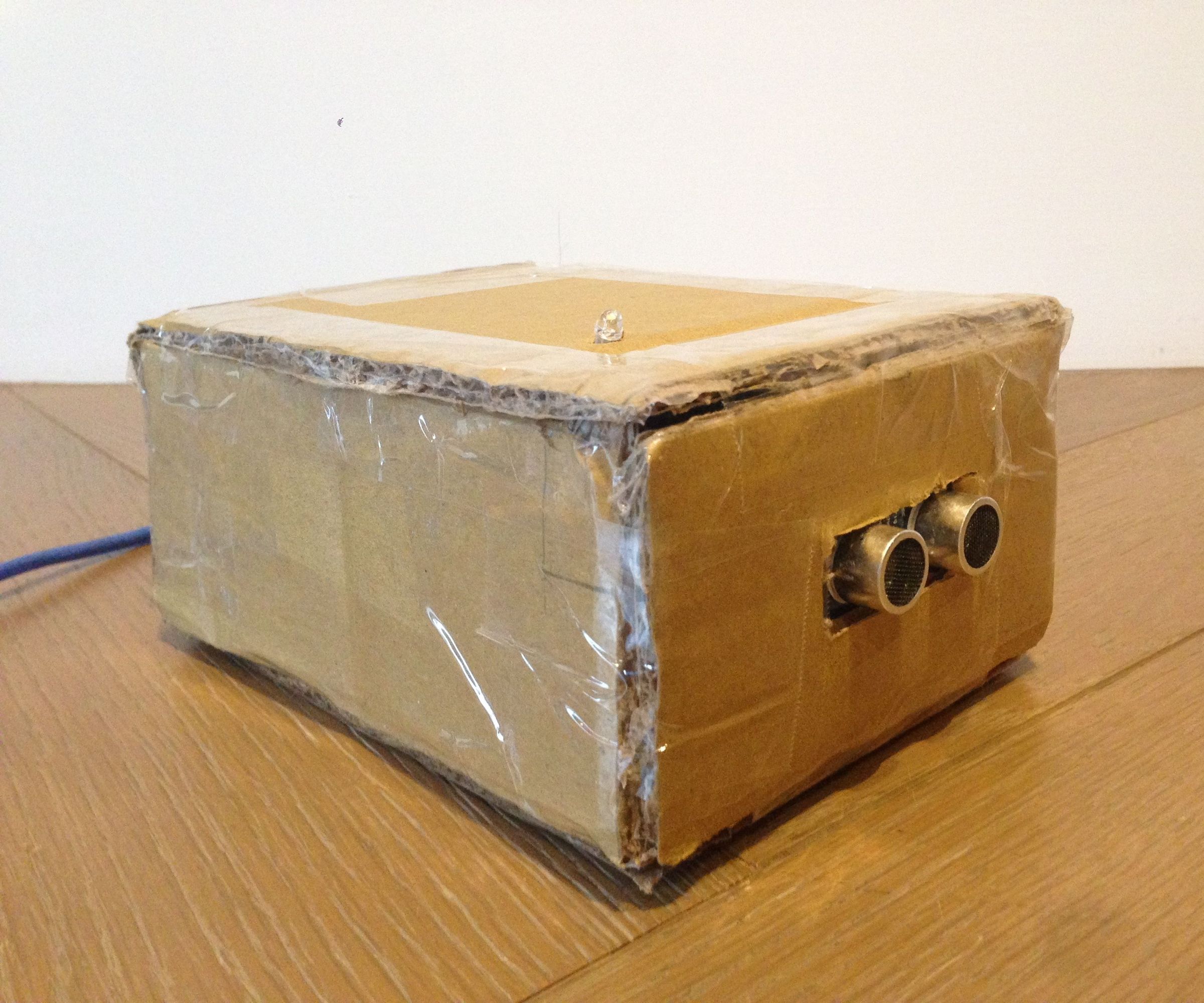

Step 2: Finding Your Container
The following steps are completely OPTIONAL. You don't need a container for this to work. However, a container does serve as protection and improves the physical appearance of your device (depending on how well you do it, of course).
The container I used for my Arduino board is 20.2 x 11.5 x 12.3 cardboard box. I really suggest finding a box as it is much easier and saves cardboard. As long as your box is not too big for you and not too small for the board, it is o.k. The container I chose just happens to fit the board perfectly.
Step 3: Carving Your Container
Your container requires two output holes, for the USB and the button. Therefore, you must carve a 1.5 x 1.5 square on one of the container's corners. Your must also cut a circular hole on the top of the container for your button. Since everyone's button is different, just cut the hole to a size identical to your button. Mine had a diameter of 3cm.
If you accidentally screw up the cutting (especially for the button hole), use what fell off from the cutting to make the hole more narrow, allowing the button to still fit into the hole. This is where tape is really useful, it solves all the problems. For the circular hole, simply fold the circular plate you cut off and tape it onto the hole to make it more narrow. I used a significant amount of tape for this. Tape solves everything. If it doesn't......
You're not using enough.
Step 4: Wrapping Your Container
Alright, you're almost done. HANG IN THERE!!!!!!
First, seal the box with normal tape.
All you have to do now is to wrap the box with tape. First wrap the entire box around with your tape, don't care about the cable that's extending out. You can remove it before wrapping if you want but I didn't. Make sure you skip the button. After wrapping, cut the tape in the cable hole.
