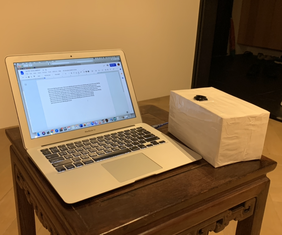

Step 3: Creating the Cardboard Box.
Take your large piece cardboard and carve the shape of the outer outline shown in the picture with your utility knife. For the red lines marked on the images, you carve only "half". What do I mean by carving "half"? Well, notice how a piece of cardboard has two layers (as shown in the illustration above with two red lines). Cutting "half" meaning cutting through only one of the two layers. We are doing this because we will be folding at the red lines, and cutting half would weaken the structure and facilitate the fold without destroying the structure. The "half" cuts are also shown on one of the pictures above.
Step 4: Punch Some Holes
Punch cavities in the portions of cardboard shown above. First penetrate the cardboard with a screw. Then insert a pencil into the tiny hole and rotate while pushing the hole larger to the size of the pencil. Remember to create a hole for the energy supplying cable!
*****A mistake is shown in the picture and is corrected by the red markings. There should be 6 holes on the upper side and one on the top side.
Step 5: Secure the LEDs and Buzzer
Place the LEDs into the carved holes. It is most likely that the LEDs will fall out, so make sure you secure tape them on with the thin tape as shown above. It doesn't really matter how you stick it, just make sure they don't fall out too easily. I would suggest first sticking them together in a row then stick the row to the cardboard. For the buzzer, just stick it right on to the three holes punches on the side with the speaker side facing out.
Step 6: Assemble the Box
Fold the cardboard together and a rectangular box should form. Tape the box together with thicker tape. You can tape more layers if it's loose.
Step 7: Code
The assembly is done!!!!!!!
Here's the link to the code. Copy and paste it into your coding application and you're good to go!
Link to code: https://create.arduino.cc/editor/novembersix/068326c0-7f98-492c-aeed-db2e751748ba/preview
Step 8: Testing
As an object moves closer to the ultrasonic sensor, the buzzer's frequency would increase and the LEDs would light up in order from green to yellow to red and white. You can carry the box around by swapping your computer to a portable charger.
