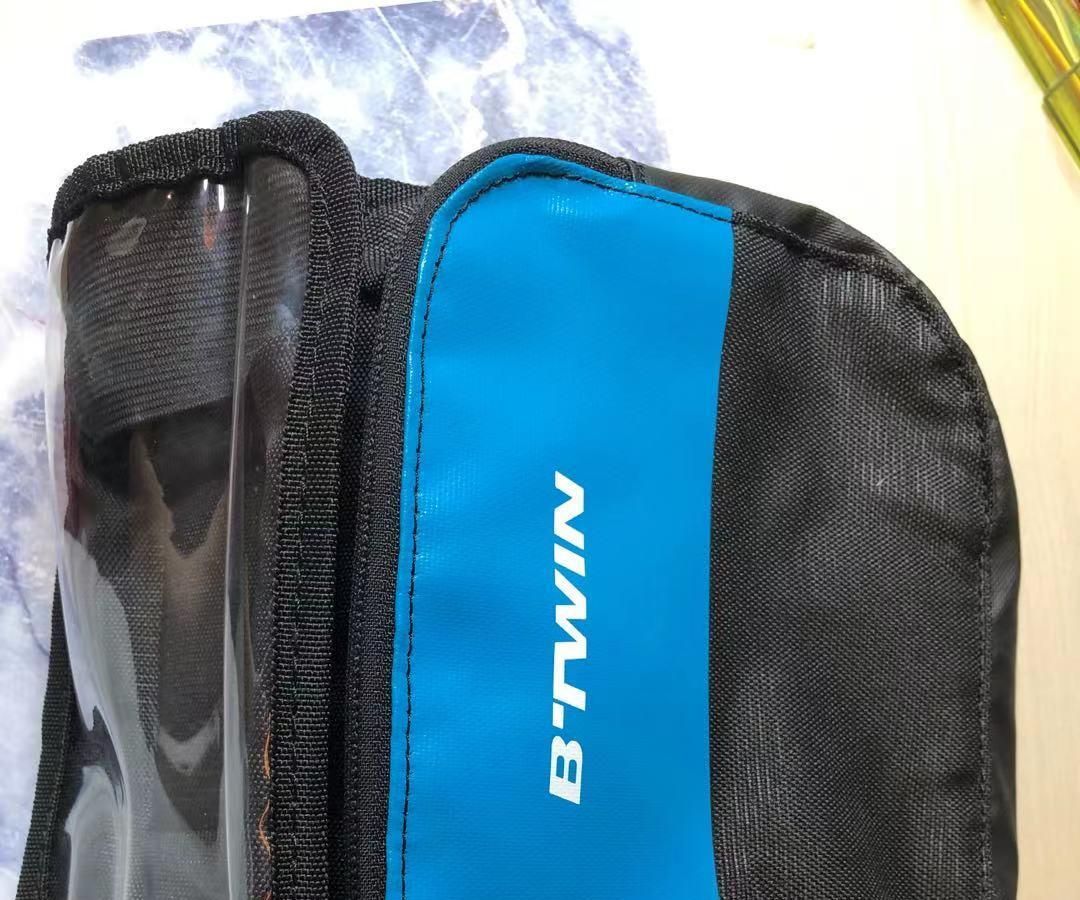

Step 3: (Optional)Find a Container!
Find a container for your Arduino so your Arduino doesn't look so messy!
Remember to dig two holes for the box, one for the MicroUSB cable to connect your device with the board and one for the button so you'll be able to start formatting.
