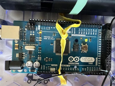

Step 3: Build the Main Circuit
I built the circuit using an Elenco Snap Circuits Prototyping Kit. You can use whatever you want (breadboard, perfboard).
Step 4: Upload the Code
Here is the code. Copy-paste this code into your IDE or open the file. Afterwards, select your board and hit upload. The ".ino" file is also included at the end of this step:

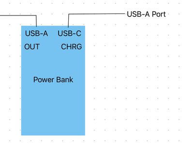

Step 5: Connect the Power Bank
Disconnect the power bank from the USB-C-USB-A wire and connect the USB-B-USB-A wire between the arduino and power bank. To make it neat, attach the power bank to your project. I just placed the power bank on the unused side of my Elenco Snap Circuits baseplate.
Step 6: Use
This detector will continuously produce a high-pitched tone in short bursts when no metal is detected. This tone will change to a low-pitched one when metal is detected. To charge, simply disconnect the arduino from the power bank and connect the USB-C-USB-A cable to the charging port. I included the full diagram with the power bank both charging and powering the arduino at the same time. This is not good for the power bank's batteries, and only the port labeled "OUT" should be connected to the arduino while using, while only the "CHRG" port connected when charging. It's just an explanation on how everything should be connected.
