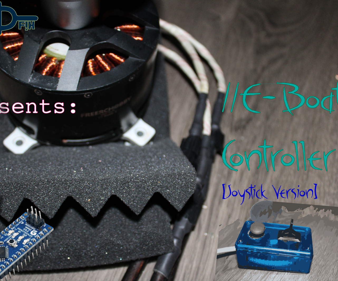

Introduction: Arduino NANO Simple E-boat Controller (Forward, Neutral, Reverse) Fixed Speed
About: //<3 Machines
Simple controller for Brushless Motor with ESC and Arduino for docking a Sail Boat.
Switch to control Forward/Neutral/Reverse
Switch to control the throttle by 3 positions.
Ignition Key Switch to turn on the controller.
Arduino Nano x1
1P2T Paddle switch F/N/R x1
1P2T Paddle switch simple x1
1KOhm Resistor x4
ESC Acording to the motor size that you will use.
Brushless Motor
Ignition Key Switch
WaterProof or Regular Connectors
Heat Shrink Tubing
Controller Box
48V Li-ion Battery
5VDC Regulator (48VDC to 5VDC)
Wires ESC to Motor
Wires ESC to Battery
