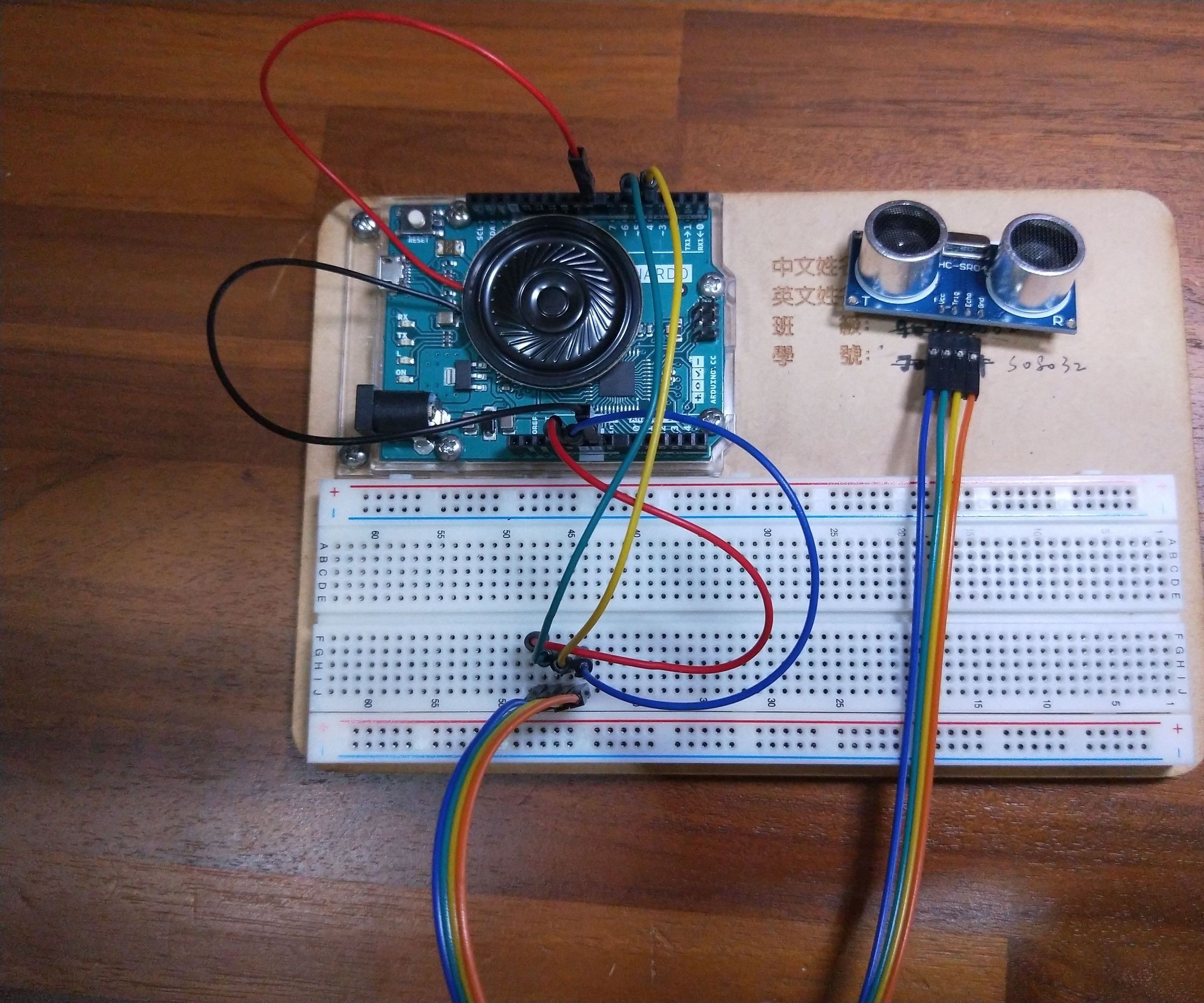

Materials
x1 Arduino board with a USB connection cable
x1 Breadboard
x1 common anode RGB LED
x3 220 Ohm resistors
8 wires
thick opaque paper
thin translucent paper (graph paper)
glue

Step 3: Code
https://create.arduino.cc/editor/AlisaLiang/d992f9...
Arduino night light code
const int redLEDPin = 9;
const int greenLEDPin = 10;
const int blueLEDPin = 11;
const int redValue = 255;
const int greenValue = 0;
const int blueValue = 0;
void setup() {
pinMode( 12, OUTPUT); 改
pinMode(redLEDPin, OUTPUT);
pinMode(greenLEDPin, OUTPUT);
pinMode(blueLEDPin, OUTPUT);
void loop() {
digitalWrite( 12, HIGH ); 改
analogWrite(redLEDPin, redValue);
analogWrite(greenLEDPin, greenValue);
analogWrite(blueLEDPin, blueValue);
