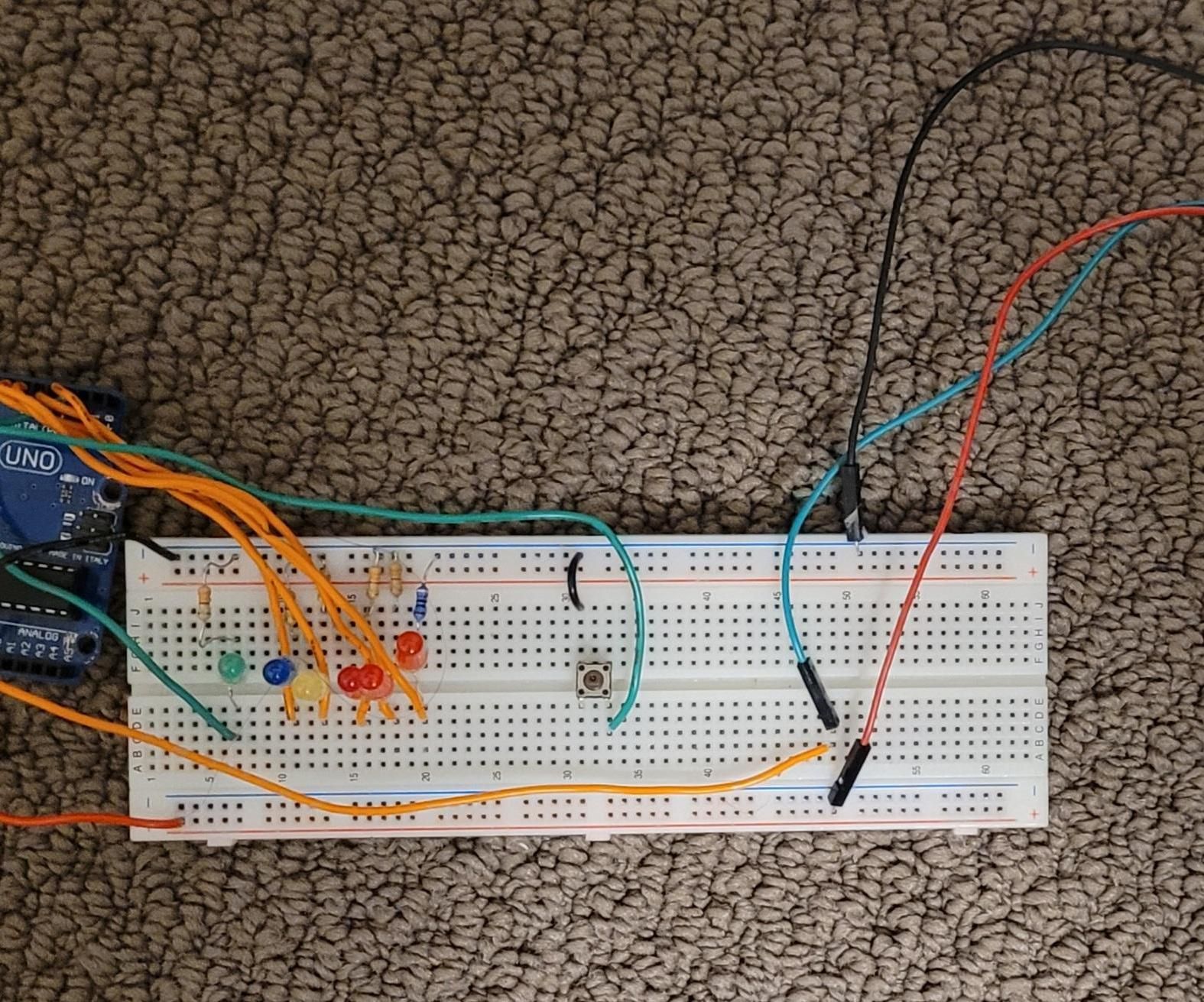

Hi, my name is Usher and I have made a player sniping bot for the FIFA 21 companion using an Arduino, the shortfuts Chrome extension, and the Processing IDE. It works by using pushbuttons to send input to the Arduino, which outputs a string to the serial monitor based on the input. The Processing program then takes the output from the Arduino and simulates a keypress based on the string printed using a switch statement.
With the Arduino Due and Leonardo, you wouldn't need the processing code since the Arduino IDE has a library that allows them to communicate with the PC keyboard directly called the Keyboard library. However, this library is not compatible with the UNO which is why the processing code is needed. To make this work for FIFA Companion in particular, I had to use the Chrome extension shortfuts to bind certain actions (buying and changing the buy it now and bid prices) to specific keys .
The switch's role is to change the function of the first button to toggle it between changing the minimum bid and buy now prices, which the Piezoelectric buzzer notifies you when you hit the buy button since if you spam it, the game will restrict you, so it is there to make sure there isn't an issue with the button, as that can be a significant problem. There are also 3 LEDs, whose roles are to remind you which button was last pressed (red for delete, green for buy, and yellow for search), and lastly, the potentiometer controls the brightness of these LEDs. The first button changes the bid/buy now prices, the second one is to search, the third one is to purchase a player, and the 4th one is to back out to repeat the process. This allows you to buy players quickly.
The reason I made this project is that it is a way to earn some coins in a game I like while doing an assignment at the same time. Since I'm buying players at prices below their market value before everyone else does, I can sell them for a profit. The profit per player ranges between 100-1500 assuming gold players are the ones bought. While this isn't the most efficient way, in my opinion, it is the coolest DIY way to do it. Now, onto the materials and other steps.

Here is the wiring for the circuit. The pins for each component are as follows(these are in the code as well):
Piezo: pin 2
Delete button: pin 3
Buy button: pin 4
search button: pin 5
Buynow/Bid button: pin 6
Slideswitch: pin 8
Yellow LED: pin 9
Green LED: pin 10
Red LED: pin 11
Potentiometer: pin A0
Note that the LED's resistors can also be put to ground instead of through power and you can use 10k ohm resistors over the 560-ohm ones in case you don't have enough 560ohm ones. In case the picture is too messy, I have also attached the circuit made in TinkerCAD. Some of the components are different, however, all the pins are the same and the code still works with it. This circuit is really easy to add other buttons to and with some small modifications to the processing code, this type of circuit will work for any type of game or keyboard shortcut.
