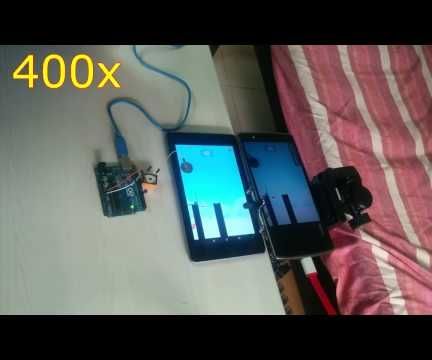

Ever wondered if your phone can play games by itself. Yes, it is possible. You can build a circuit to play Piano tiles on your smartphone.
The video shows the demonstration of the project.

We use light dependent resistors (LDRs) to sense if the tiles are white or black. Four LDRs are positioned over the screen each facing one tile. The LDRs have been connected to the back of the cardboard like this.
The LDR resistance changes with the intensity of Light. Higher the intensity of light, lesser the resistance. LDR is placed in a Voltage divider circuit to produce a voltage proportional to its resistance.The LDRs are connected to the analog input pins of the Arduino as shown.
Practically, this is how you would connect the circuit. You can check the test_ldr code to see if the LDRs are working fine. When you run the code, you will get a high value from the LDR if it’s sensing black, else you get a low value.

We are going to use this concept, except that in the place of a finger, we use the ground pin on the arduino to transfer the charge on the screen. To have more surface area on the display of the screen, we use a coin.
Relays are directly connected to the output pin of the Arduino. It is equivalent to a touch if the voltage given is high as there is a path for the current to flow to the ground. It is equivalent to not touching if the voltage given is low.

Once you the connect the circuit and dump the code main.ino at this link, your circuit should start working. If not, it is because the delays are not adjusted perfectly. Tweak the delay values in the code and it should work.
And you built a circuit that can play Piano Tiles better than any human in the world!!
