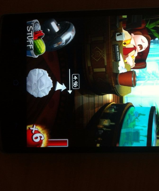

Are you a gaming freak? Want to top the high score list? If your answer is yes you are at the right place.
Can all this be achieved with you sitting idle and your phone doing all the talking? Yes it can be done and we’ll show you how. You can see the video demonstration above.
Stick hero is one of the world famous, time eating game with over 10 Million Downloads. To download the App on your smart phone click here.If you are new to the game, have a look at the game play here.

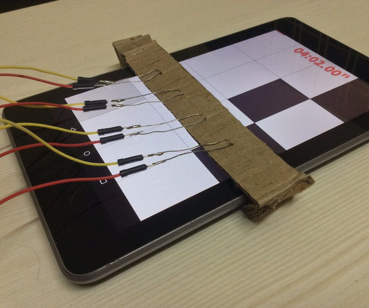

Single Strand Wires, Coins, Relays are used to simulate the touch on the capacitive touch screen of phones and tablets. Arduino is used to control the duration of the touch. Tripod, for holding a phone above the camera.

Step 5: Simulating Touch
For this we have to understand how capacitive touch screens work. The electrodes apply a low voltage to the conductive layer creating a uniform electrostatic field. When a finger hits the screen a tiny electrical charge is transferred to the finger to complete the circuit creating a voltage drop at that point on the screen. The location of this voltage drop is recorded by the controller and this is how a capacitive touch screen works.
We are going to use this concept, except that in the place of a finger, we use the ground pin on the arduino to transfer the charge on the screen. To have more surface area on the display of the screen, we use a coin.
Relays are directly connected to the output pin of the Arduino. It is equivalent to a touch if the voltage given is high as there is a path for the current to flow to the ground. It is equivalent to not touching if the voltage given is low.
Run the test_relay code at this link to see if the electronic touch is simulated properly.
