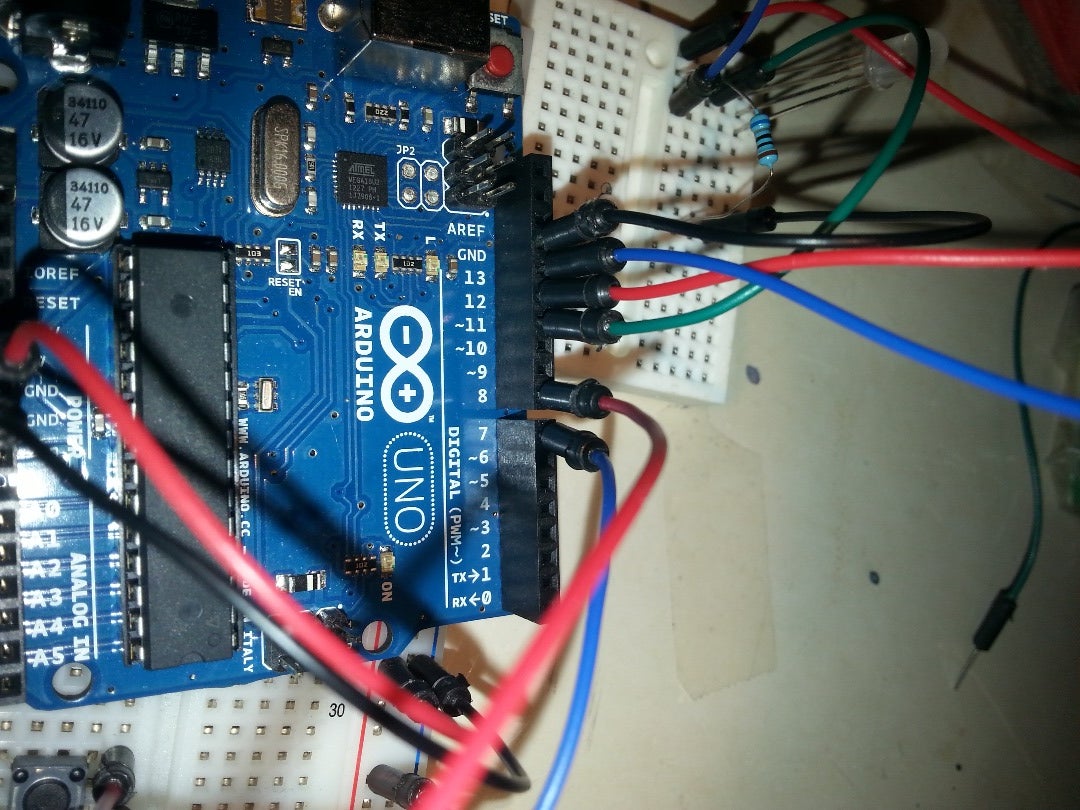

Step 4: Wiring the LED
This is the most complicated part. You shouldn't do a lot of damage if you do something wrong here, but it's frustrating to fix!
Keep in mind that if you modify the code,your pins may vary!
Also,I Strongly recommend you keep your Arduino unplugged while doing the wiring.
Step 5: Wiring the Power Lanes
It's not necessary to wire the power lanes, but it's handy, and we'll need only one there.
Step 6: Wiring the Buttons 1/2
This it it, last step before testing! Saddly, the most complicated one.
If you want/need more detailed explaination, I'll update the Instructable!
Step 7: Wiring the Buttons 2/2
It's exactly the same process, except for the last wire. It goes in the pin 8 of the Arduino.
Step 8: Testing!
Finally!
Indeed,finaly. Altrough, I recomend you double-check your wires before pluging the Arduino on, you never know!
Yes, I learned the hard way.
