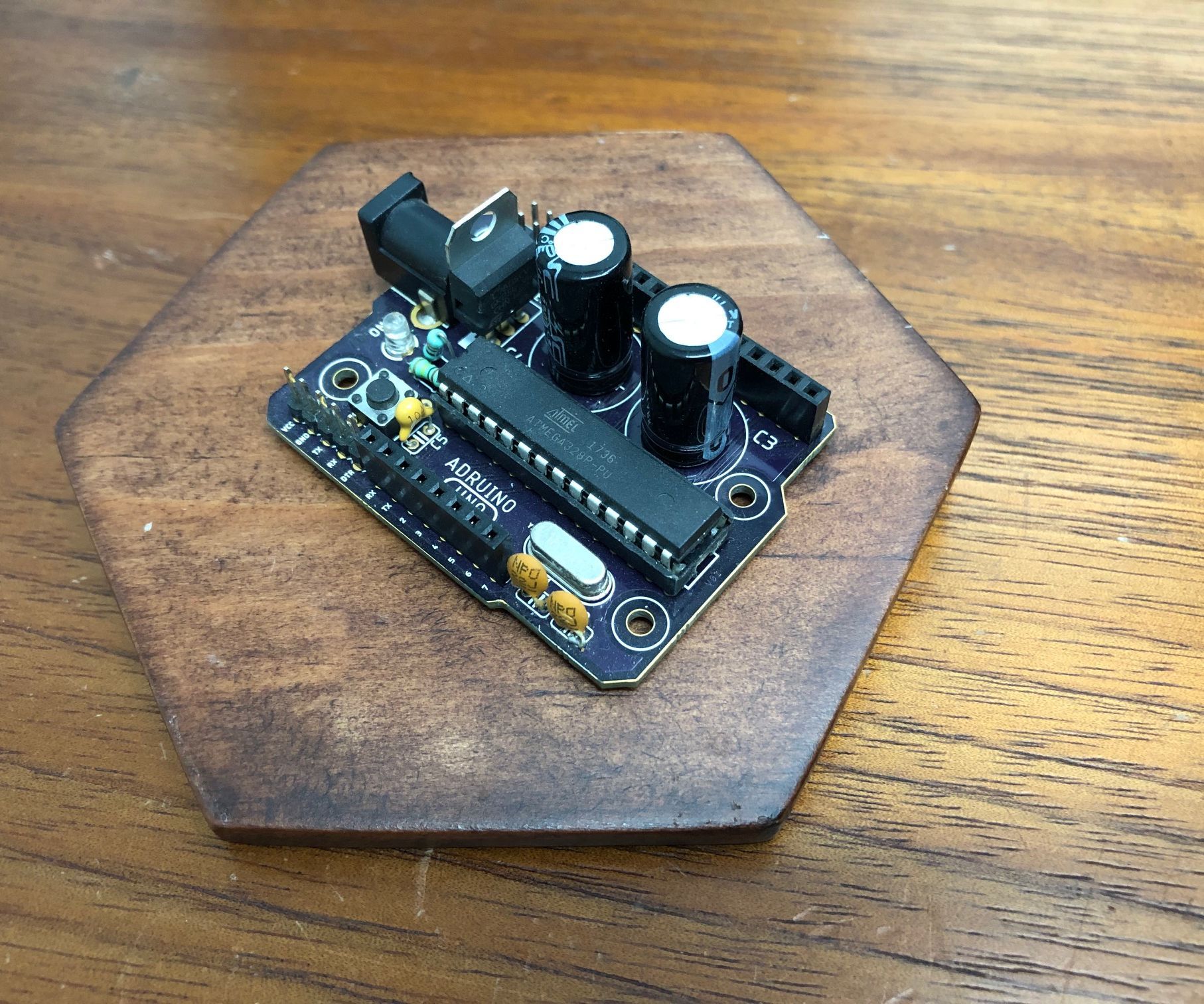

Hi there,
This weekend I found a QDSP display lying arround my office and I never worked with one before so I thought it would be a nice weekend project, I searched on internet about this display made by HP, and I found almost no information about it, there is no Datasheet and it took me a while to find out how to send the information.
The QDSP Display its called an "smart" display because it has a ROM inside that has 128 characters in ASCII so you can print them by sending the right address and selecting the position.
So, with this information I made a code in Arduino to control it just by tiping the phrase in a Char.
Hope you like this instructable!
Step 1: Finding the PinOut
As I said there is no Datasheet availabe so I tried with the same pins as the HDSP displays also made by HP, and foutunately it has the same pinout.
So I made this schematic.
