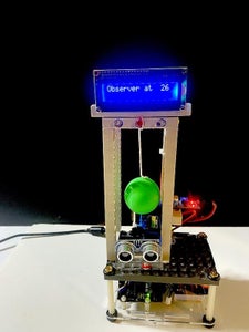

Step 1: Finished Construction
Here is a YouTube video of the finished construction.
Step 2: The Do Nothing Sequence
This Do Nothing Machine includes 6 different functionalities. When there are no nearby observers the device just sits there and blinks. An Ultrasonic sensor detects a person has approaches. A two-line LCD display that shows the distance measured by the ultrasonic sensor of an approaching observer. When a person is closer than 75 cm it triggers the device to become active. First, the LEDs change color and blink differently. Then an IR obstacle/beam-break sensor detects when a hanging ball is hanging still. If not moving, it triggers a servo to move a small paddle to tap a hanging ping-pong ball to make sure it is not swinging. Then the servo rotates back, and swings to hit the ball. That causes the ball to swing back and forth. As it swings, it breaks the beam of an IR obstacle sensor on each swing. This causes the LED to blink and a piezo buzzer to buzz on each swing.

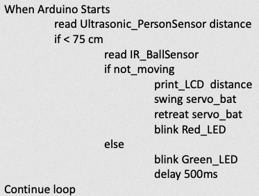

A simplified pseudo code sequence of the Arduino sketch program is shown in the first figure. The second figure shows a TinkerCad wiring diagram of the components connected to the Arduino.

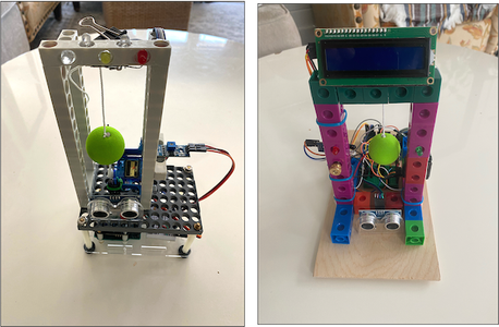

There is nothing special about the structural framework for this project, so use your own ingenuity! The only requirement is an overhead frame that can hold a suspended ping-pong ball, the servo motor, and IR sensor.
The structural components in the image on the left are parts from a Thames & Kosmos kit. The second image is made with Snap Cubes. But any type of structural construction can be adapted, including foam core, Lego, ErectorSet, etc.
The ping-pong ball (or other foam ball) can be attached to thin string or thread about 6" long. That can be done with superglue or poking a pin or brad-nail into the ball and tying the string around the pin.
LEDs, the piezo buzzer and (optional speaker) can be mounted anyplace.
In this construction the Arduino is mounted under the frame holding the ball, but the Arduino could be mounted anyplace as long as the connecting wires reach.
