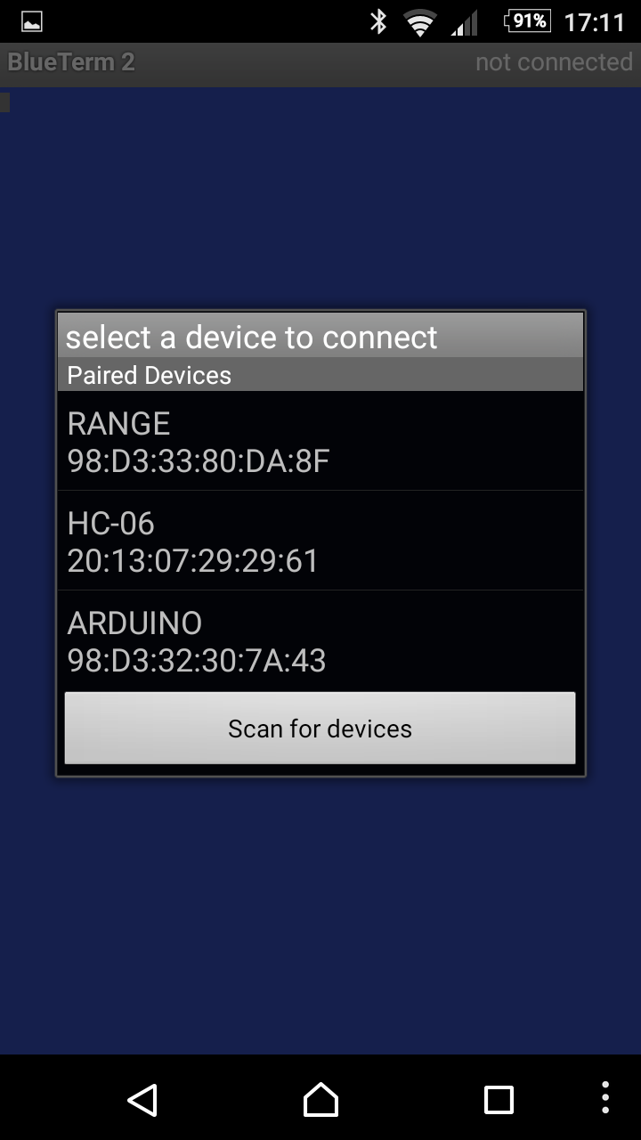

There are many Bluetooth apps available and many are free. I use Android phones but I expect the same is the case for the other systems. I decided to use BlueTerm 2 as it also provides the option to log the data received to file. I also found it very straightforward to use. So go to Google Play and request download of BlueTerm 2.
When you have the app installed you can connect to Bluetooth devices. Note that Bluetooth device first need to be paired with the phone before they can be used in any apps:
Turn on BlueTooth: I go via Settings>Bluetooth.
The phone will list already paired devices and after a few seconds then show Available devices. The name might initially show as a set of numbers rather than the device name. However selecting it then shows the name and asks for the PIN that is usually 1234.
Now start BlueTerm 2. Click settings, then click Connect device and select as required. You can just power up a HC-05/HC-06 module at this stage and check the pairing process if you wish (attach negative supply to ground and 5v to Vcc).

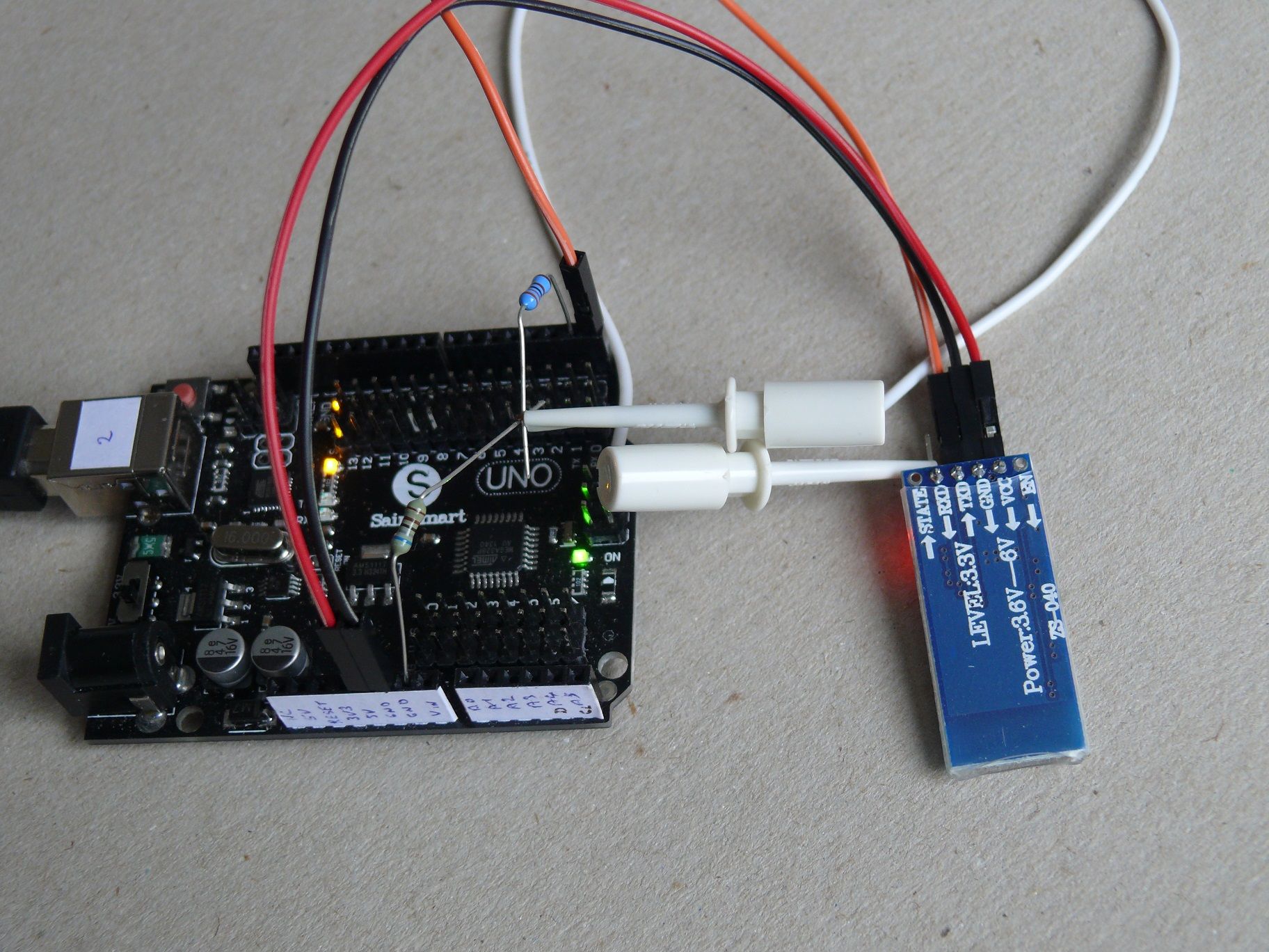

Connection for configuration
With sketch loaded we can now connect the Bluetooth module to the Arduino board. The Tx and Rx connections are swapped compared to what we will do later as we want to communicate with the PC port for the Serial Monitor and not the Arduino main processor. The PC Tx is connected to the Arduino Rx and vice versa.
Note that the Bluetooth modules have 3.3v levels for Tx and Rx. Hence a voltage divider should be used for the Bluetooth Rx input when connecting to 5v systems. The Bluetooth 3.3v Tx output is usually detected fine by 5v systems and hence can be connected directly.
I have found that a voltage divider using 3k3 and 6k8 resistors works up to 115200 serial baud rates.
The HC05 and HC06 modules have on-board voltage regulators and hence run with Vcc connected to 5v.
So connect :
- 3k3 resistor to D0
- 6k8 resistor to ground
- Connect the other ends of the two resistors together, and to the Rx pin on the Bluetooth module
- Connect the Bluetooth module Tx pin to D1
- Connect the Bluetooth module ground pin to GND Connect the Bluetooth module ground pin to GND
- Connect the Bluetooth module Vcc pin to 5v
See picture for detail.

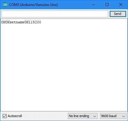

HC-06
These are the easiest. They set themselves into AT mode if they are not paired with any device. However the baud setting will be whatever the normal operating baud has been set to. This is normally 9600 when supplied. If this does not work try 38400 or the other common rates.
Connect the USB lead from PC to Arduino and start the Arduino IDE. The Bluetooth LED will flash rapidly (~4Hz) when in AT mode.
Open the Arduino Serial monitor via Tools>Serial Monitor. Set the baud to 9600 and set ‘No line ending’.
Now enter AT and click Send. If all is working you will see ‘OK’ returned to the monitor. If nothing comes back double check the wiring and try different Baud settings.
With an OK confirming good communications we can change the name and set out own Baud rate.
Enter AT+NAMEARDUINO and click send. This sets the module name to ARDUINO. Any other text can be used. Note no spaces in the command.
The reply should be OKsetname. This gets added to the OK sent earlier
Now enter AT+BAUD8. This sets the baud to 115200.
The reply should be OK115200. If any more AT commands are to be sent the Serial Monitor baud setting must be changed to 115200.
Other rates can be set. Baud4 is 9600, Baud5 is 19200, Baud6 38400, Baud7 57600. There are higher settings than 115200 but check first that your PC and Arduino can accept them (mine cannot exceed 128000). Note - If you set a rate that is too high you will not be able to communicate with it to set it back!!!

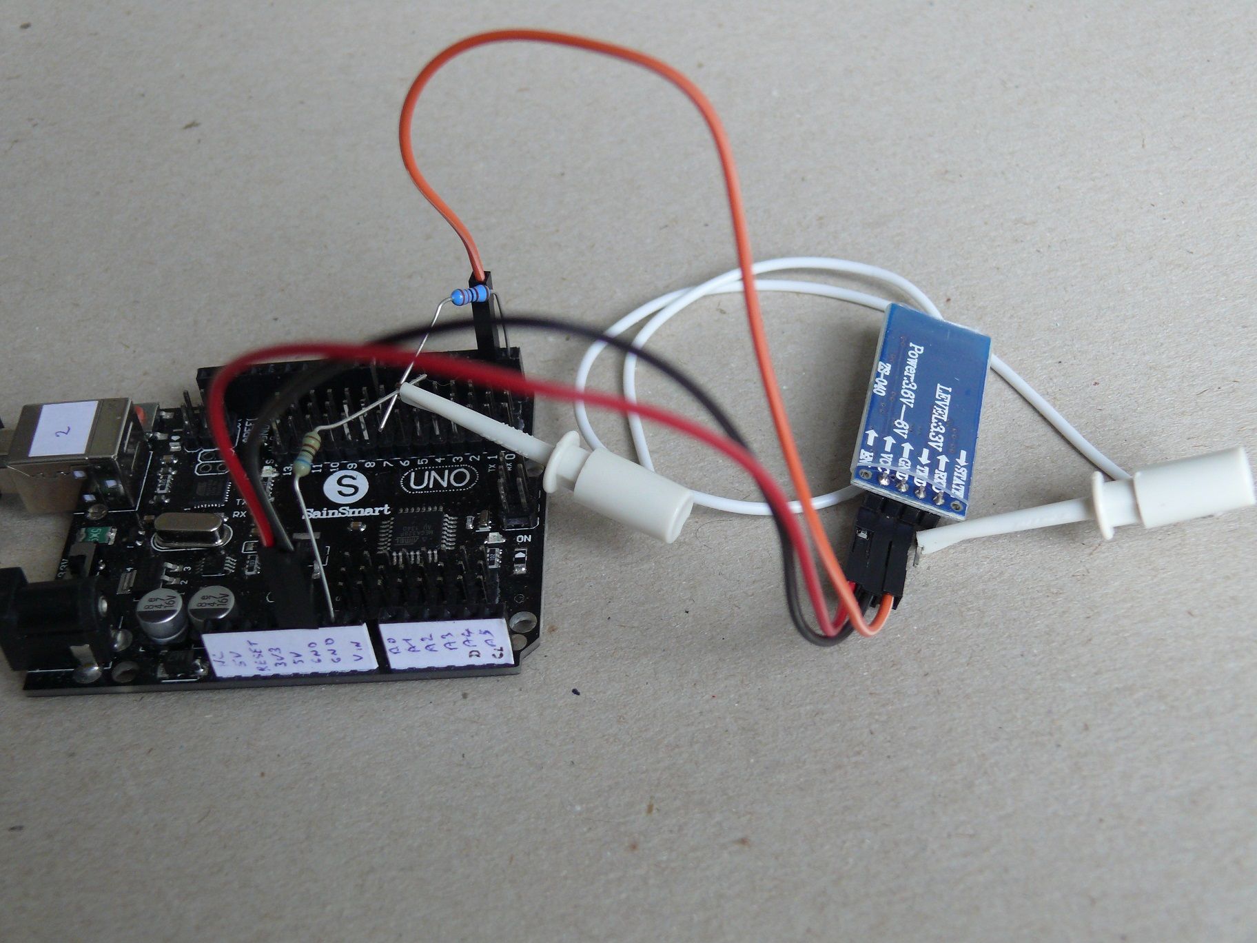

Step 4: Connect Bluetooth Module to Arduino
We need to load our Arduino test sketch first. The attached BTtest.ino sends a number every 0.5s and then increments it, rolling over to 0 from 255. Create a folder called BTtest in your sketches folder and add BTtest.ino
The Arduino serial connection is also used for downloading sketches. So the two wires to the Bluetooth module must be disconnected so that it does not interfere.
After downloading the sketch reconnect the Bluetooth module. Note however that the Tx and Rx on the Arduino need to be swapped compared to the earlier configuration setup.
So connect :
- 3k3 resistor to D1
- Connect the Bluetooth module Tx pin to D0

Pair the board to the smartphone if not already connected (see Install Bluetooth app above). Then start BlueTerm 2, click settings, then click Connect device and select ARDUINO. You should see the screen fill with numbers incrementing from 0 to 255.
