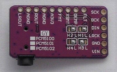

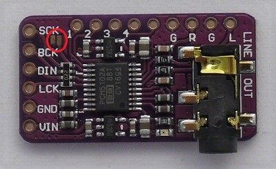

I decided to use a different digital audio board to my earlier HQ Audio project, still a PCM5102A. This is because this one is easier to wire up. A number of connections (settings) can be set via solder bridges on the board. The one I got had the default settings already set and I only had to bridge the link to set SCK to ground.
First solder the PCM5102 board links. There is one on the top side to link SCK to ground. We need the board to use its own clock and it will only do this is there is none on the SCK input. Then, if needed, close 3 of the four links on the bottom of the board to ‘L’ (1, 2, 4) – for FLT (normal filter), DMP (De-emphasis off) and FMT (format I2C). Link ‘3’ to ‘H’ - XMT (software mute off).
There are 5 leads to connect to the Pi. However if the amplifier is being driven from the same power supply (common ground) it is better to connect the ground on the PCM5102 board to the ground on the amplifier input in order to eliminate noise on the ground wiring. The connections are:
Board | Connect to | Pi | Function |
VCC | 5v | pin 2 or 4 | Power |
GND | GND | pin 6 or 14 | Ground |
LCK | GPIO19 | pin 35 | data word clock |
DIN | GPIO21 | pin 40 | data |
BCK | GPIO18 | pin 12 | data bit clock |

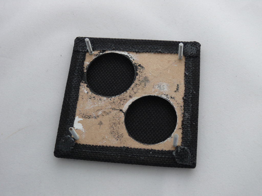

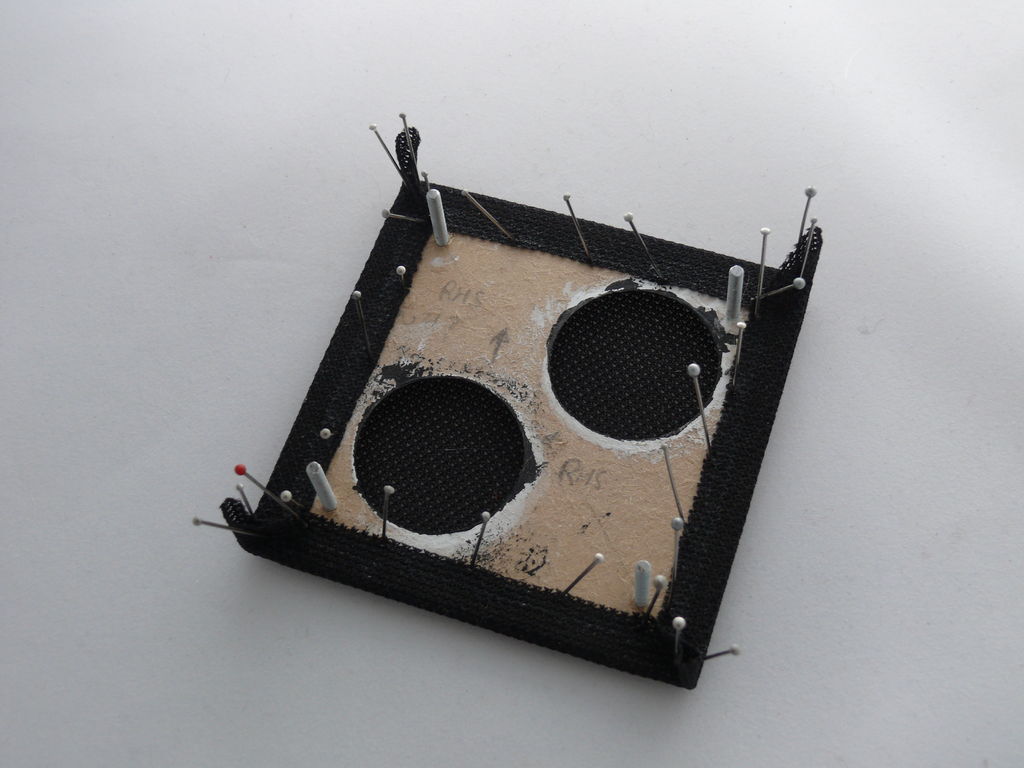

I made the enclosure from 9mm MDF board. I wanted to minimise the height for the under-cabinet location. This led me to mounting the woofer downwards plus making rebates in the top and bottom panels. I used a hole saw to make the holes for the smaller speakers and cut the woofer hole with a coping saw. I then made rebates for the speakers using a router carefully by hand.
I made speaker grilles from 3mm MDF. After epoxying screws in place I sprayed these black and then covered in speaker cloth.
![](https://content.instructables.com/FY7/C5OK/K5F4H5LE/FY7C5OKK5F4H5LE.LARGE.jpg?auto=webp&frame=1&width=1024&fit=bounds)
See below the completed internals:
![](https://content.instructables.com/F69/KQ19/K5WTO0A0/F69KQ19K5WTO0A0.LARGE.jpg?auto=webp&frame=1&width=800&fit=bounds)
The plan is to finish the case in vinyl but we plan to change the kitchen units and hence will select the vinyl to match.
