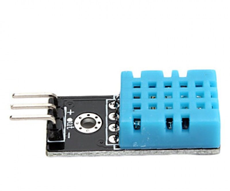

PinOuts Of LM35 is Shown in image.
You can download the datasheet from below file.
Step 1: Hardware Required and Circuit Diagram
- Arduino Board (Any) Buy it from Flipkart
- LM35 Sensor Buy it from Flipkart
- BreadBoard
Connect the Circuit as shown in image and upload the following code.
