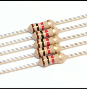

So here is the list of materials-
1.2N2907 PNP transistors x 2
2.2N2222 NPN transistors x 2

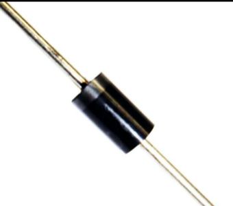

3.1 k ohm resistors x 4
4.1N914 diodes x 4

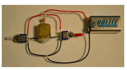

Step 2: What Is an H-Bridge Motor Driver???
An H-Bridge motor driver circuit can be easily understood by looking at the images above,it mainly comprises of the two switches that is replaced by transistors in our circuit.....

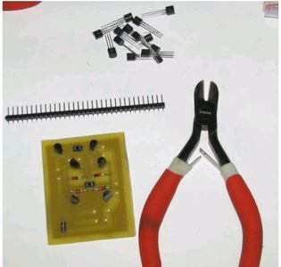

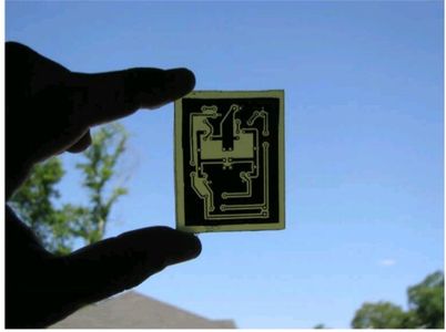

Step 4: Etching the Circuit...
I provided the pics,so that it may be easy for you to make the PCB design,I designed it use Eagle Cadsoft,you may use any software or you can also do it manually....

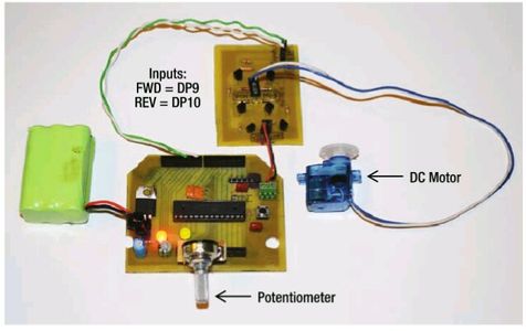

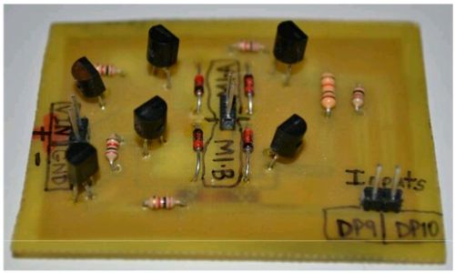

Step 5: The Completed Circuit.
After etching the circuit you may solder the components as shown,and may plug the Arduino pins in the motor control pins in the board(marked as "In 1 & 2" in the circuit diagram)and connect the motor pins in the motor terminals....
