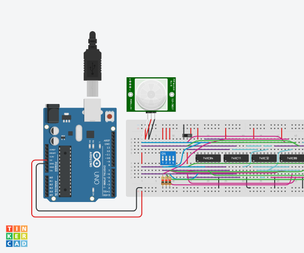

Step 2: Assembly of Parts
Now that we have all the necessary parts to finish this circuit, the above pictures should give you an idea of how to wire them up. The images were taken from the circuit being done online using Tinkercad. (But between you and me, it works better with real-life components.)
We're wiring just one switch of the Dip Switch to power and using a 10K ohm resistor for ground. We are connecting it to digital pin 2. The RGB is a common anode, so we are using a 330-ohm resistor to power that and the other legs are connected to PWM pins (3, 5, 6). The Distance Sensor is connected to power and ground while "trig" is connected to pin 9 and "echo" is connected to an analog pin (A0).
The 7 Segment Display is a common anode, so we have connected its common pins to power using 330-ohm resistors. The 7 pins (excluding the DP pin) are connected to digital pins on the Arduino. We are also connecting the top and bottom rails of the breadbaord for both power and ground. This way the current from the Arudino flows through the whole breadboard now.
Step 3: Wiring
After you got an idea on how the wiring works, we are ready to wire it ourselves with the actual parts. The images above provide a design of how it should look, although the wires are kind of all over the place.
Make sure that when you are wiring, there is no copper seen to the eye. You can colour code to better understand which wire is connecting what. I like to use red wires for power and black for ground.
The rest are connecting the components to digital or analog pins. You can also see how the wires are connected to pins in the image above.
