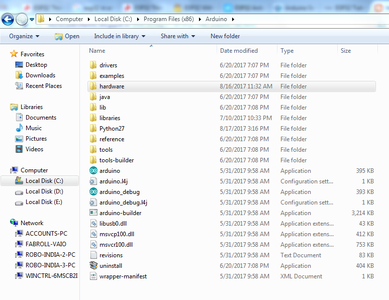

1) Download the Arduino UNO R3 as this link and then Unzip all these files.
2) Copy and paste the Folders in :-
Example :-
My Computer in C:/Program Files (x86)/Arduino

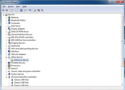

4) Once the System window is up, open the Device Manager.
5) Look under Ports (COM & LPT). You should see an open port named “Arduino UNO (COMxx)”. If there is no COM & LPT section, look under ‘Other Devices’ for ‘Unknown Device’.
6) Right click on the “Arduino UNO (COMxx)” or “Unknown Device” port and choose the “Update Driver Software” option’
7 )Next, choose the “Browse my computer for Driver software” option’
8) Finally, navigate to and select the Uno’s driver file, named “ArduinoUNO.inf”, located in the “Drivers” folder of the Arduino Software download (not the “FTDI USB Drivers” sub-directory). If you cannot see the .inf file, it is probably just hidden. You can select the ‘drivers’ folder with the ‘search sub-folders’ option selected instead.
9) In windows will finish the driver installation.

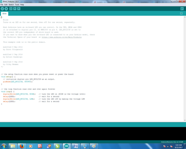

Open the Arduino application than Go to the File > Examples > 1. Basics > Blink

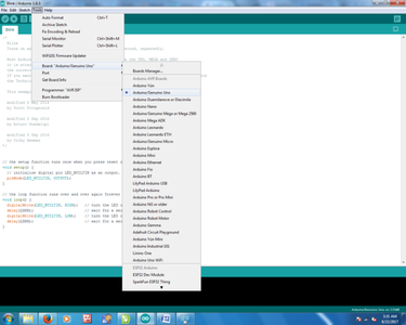

Step 5: Select the Type of Arduino Board You’re Using: Tools > Board > Your Board Type:

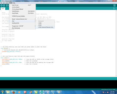

Step 6: Select the Serial/COM Port That Your Arduino Is Attached To: Tools > Port > COMxx:
Step 7: Next Step:
If you’re not sure which serial device is your Arduino, take a look at the available ports, then unplug your Arduino and look again. The one that disappeared is your Arduino.
With your Arduino board connected, and the Blink sketch open, press the ‘Upload’ button.
Step 8: Last Step:
After a second, you should see some LEDs flashing on your Arduino, followed by the message ‘Done Uploading’ in the status bar of the Blink sketch.
