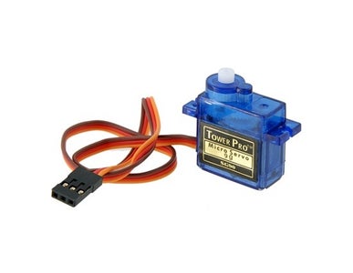

- Arduino One
- 2x Servo motors (SG90)

It pretty hard to get the lego so that it works, and connect the servo's to the lego. I used some screws to screw a cog-wheel to the servo.
I used one servo to open the door of the box and the other for moving the switch back (turn it off again). When you are done with the mechanical part you can close it all up.

Connect the 5v from the Arduino to the + of the breadboard and the GND to the - of the breadboard. Next connect the + and - of the breadboard to the + and - of the servo's and connect the signal wires to the A0 and A2 of the Arduino (I connect everything to the breadboard first)
