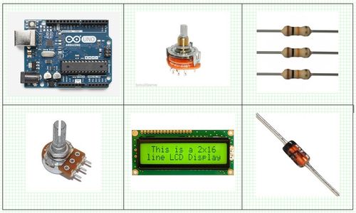

Parts and components
Arduino Uno board
16x2 LCD = 1 No
1K Potentiometer = 1 No
4 Way, 2 Pole Rotary switch = 1 No
Resistor 10 K = 4 Nos
Resistor 1 K = 1 No
Resistor 9 K = 1 No
Resistor 90 K = 1 No
Resistor 900 K = 1 No
IN5913B 3.3 Volt Zener diode = 1 No
