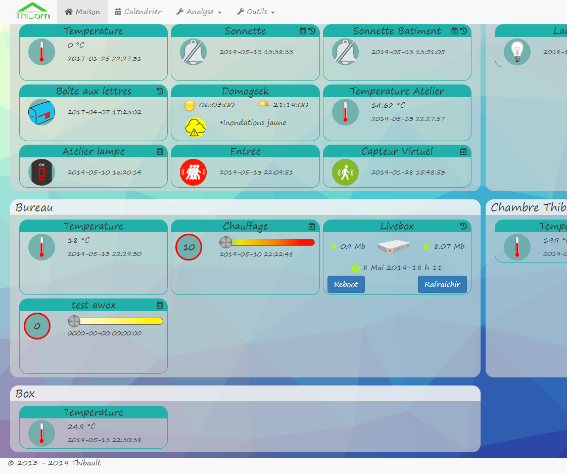

Step 9: Web Interface
Home page with all module, when the user click on icons an action is send to the raspberry who send to the master with the USB and sent to the right module.
