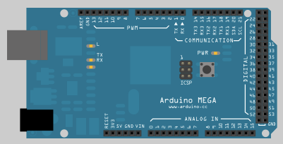

Arduino is a common name for a group of MC . There are multiple MC according to your use . If you are searching for a general go with Arduino UNO , if you want it compact version go with Arduino NANO ,If you want multiple number of pins and for multiple interfacing Arduino MEGA

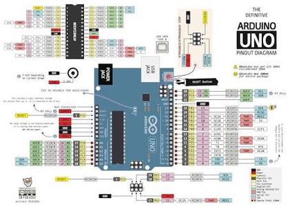

I'm going to explain about Arduino UNO since it is a general MC board
# PROCESSOR #
Main part of any micro controller is a Micro Processor. If we are taking our brain as Microcontroller then Cerebral cortex will be the microprocessor . It takes in put processes according to our code and gives out put. 4004- is the first microprocessor and Arduino Uno has ATmega328P processor.
#GPIO#
GPIO- general purpose input output pins
Name explains everything. These are programmable pins according to your program they act as input or as output
Arduino Uno has 14 GPIO pins. Among GPIO pins 6 pins are PMW(Pulse Width Modulation)
#analog pins#
This is a feature we can see in modern MC boards. It contains analogue to digital converter .So you can give up to 5v analogue value input directly to your board. Arduino Uno has 6 analogue pins
#UART#
UART's are combination of Rx(receiver) Tx(transmitter) UART will control your serial communication with PC or with your serial communication device such as BLUETOOTH, WI-FI etc. While you up load the code u can se Rx blinking in your board .
Arduino Uno has 2 UART usually if u go for higher Arduino u will get more.
# CRYSTAL OSCILLATOR #
Crystal oscillator controls time inside a micro controller pulse width, delay , time period anything related to time will dippends on Crystal oscillator
while Arduino UNO has 16MHz.

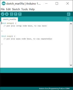

Arduino language is java based language if you know java u can understand this easily. But don't worry it's just a simple language.
Main Elements
void setup-
here. u will type the commands which shud exicute only once
void loop-
Commands here will exicutes infinite times
pinMode-
pinMode(pin-number,mode);
This is used to define a pin is output or input . For analogue pins u have to give 'A' with the pin number
digital/analogueWrite-
digital/analogueWrite(pinNumber,HIGH/LOW);
This is used to make an output pin as high or low
digital/analogueRead-
variable = digital/analogueRead(pinNumber);
It will save the value received from the pin in veriable
These are the basic commands of ARDUINO it contains more library's and commands if u need anything more deep just GOOGLE-it !!
