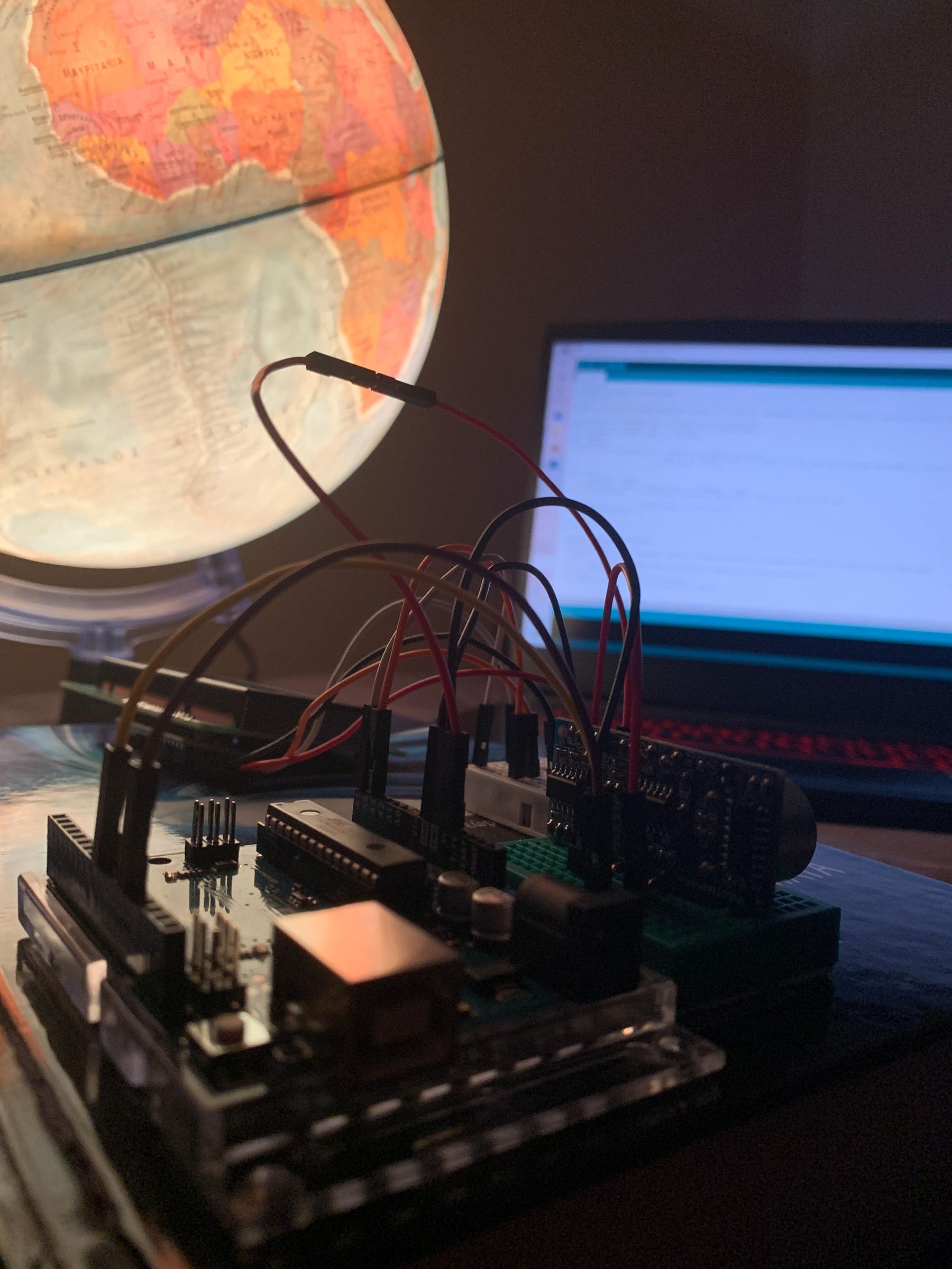

COMPONENTS :
- An Arduino Uno
- A LCD 19x4, 5V (16 pins)
- A IIC/I2C module (16 pins /4 pins )
- 4x Male to female cables
Why we use the I2C module and not just the LCD monitor?
Because we save 12 cables. Our life will be easier!

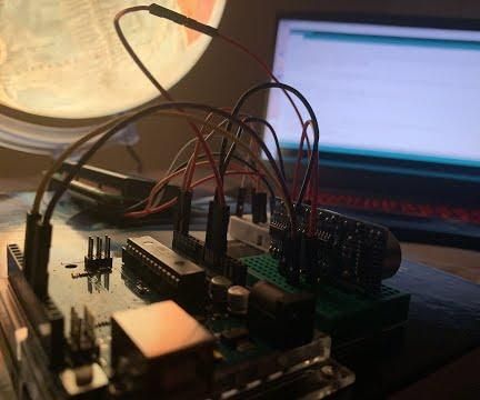

Step 2: Connections Between Arduino and I2C Module
GND(I2C) -->GND
VCC(I2C) -->5V
SDA(I2C) -->A4
SCL(I2C) -->A5
Note that SDA means serial data line and SCL stands for serial clock line.

Step 4: The Results!!!
