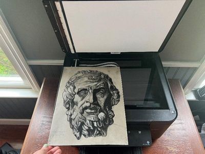

Step 5: Place Artwork
To begin the scanning process, first place your artwork of choice into your scanner. The scanner pictured below requires you to place it face down and align it with the lower right corner of the scan screen.
Step 6: Close Scanner
Once you have placed your artwork in your scanner, close the scanner door.
