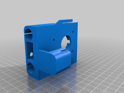

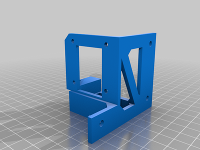

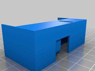

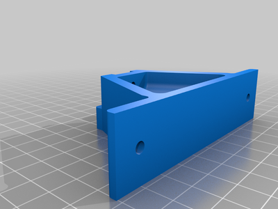

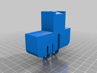

--After making the designs we move on to the 3D printing process of the pieces that we are going to use--
