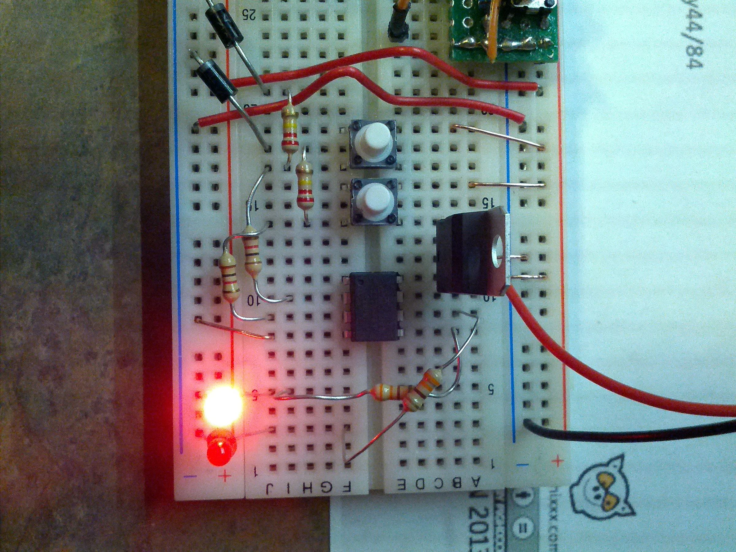

Step 2: Circuit Board Layout
Here is my circuit board layout, it is simple and easy fit on a a small circuit board. It also should be easy to assemble.
The 2 output channels will be on the pins 0 & 1 , this are PWM outputs. The pins 3 & 4 will be input pins for the Buttons
Importand, dont wire the Transistors wrong, it can destroy them!
In the circuit plan i made a mistake, the diodes have to go to GND (0V) not to 5V!!!

Nice projects, just a few ( more or less constructive ;) comments:
1. You should check the statement
"Output Current per channel: 500mA"
The proposed BC548 bears an Absolute Max of 100 mA, other small TO-92 size NPN transistors are usually in a similar range.
2. Amazing how dim the leds in your video shine, even without resistors ;)
3. I don't understand the 220k + reverse diode connected to 5V
Shouldn't that rather go to GND ?
Or, even simpler ( - 6 parts ): connect the button to GND, use the attiny internal pullup and digitalRead.
Reply 9 years ago on Introduction
1:
http://www.philohome.com/sensors/gp2d12/gp2d12-dat...
2: I wondered about that too, but 4,3V Leds and 4,34V Output Voltage ;)
3: FUUUU, a mistake i did, sure they have to be against Ground!!!!! I will change that as soon as I can!
