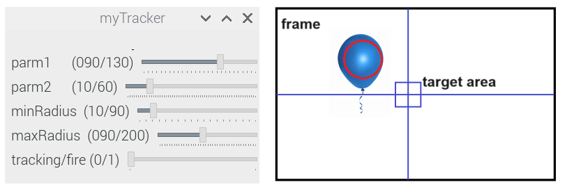

To facilitate detection, I am using the trackbar function in OpenCV to make adjustments much easier, as shown above for adjusting parameters. After the balloons are identified, the tracking and firing functions can be activated. The program automatically sorts the balloons based on their diameters, singling out the largest balloon in the current view and drawing a red circle around it. Using the pan and tilt mechanism, the camera and laser are moved until the largest balloon is approximately at the center of the frame. The target area is set at 5% of the frame width. After the balloon stays in the target area for a period of time, the laser is automatically activated, and a laser beam is fired. The loop continues to find the next largest one, draw a red circle, and pop it until there are no balloons left in sight. You can download the program from my GitHub repository.
