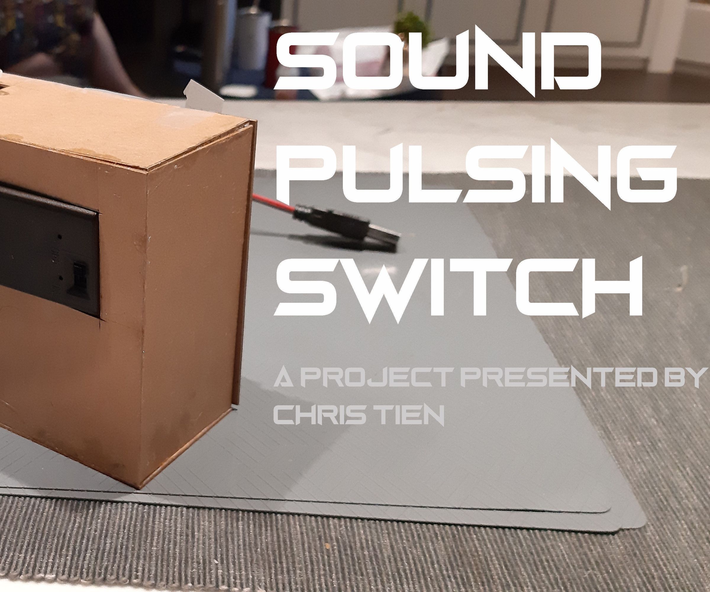

Ever had the annoying experience where others might bother you while you are trying to concentrate whether on work or a study session. During this time, an Automatic Attacking Machine might prevent you to be irritated by those annoying people. This machine would eventually stop them before they enter your room or office.
Through the reference website, you can see that only the LED Light and LCD Monitor would appear warning the user; however, in my project, I decided to use a direct current motor to confuse the "invader" by using cardboard which contains a fancy drawing on it, before they come near to further bother you.

Step 2: Step 2: Create the Model
In this project, I decided to create the model by using cardboard, with a base of a flat pearl plate. The model shape can be seen down there with the 3ds Max drawing.
In the drawing, you can see that I've created exact holes for the different pieces of equipment to stuck in, and this would vary throughout the different type of equipment you use. Also, the scale can be decided by your own depending on the size of your board. So, this 3ds Max drawing is only for sampling, just take it as a reference, take the pieces you need, but do not copy exactly!
