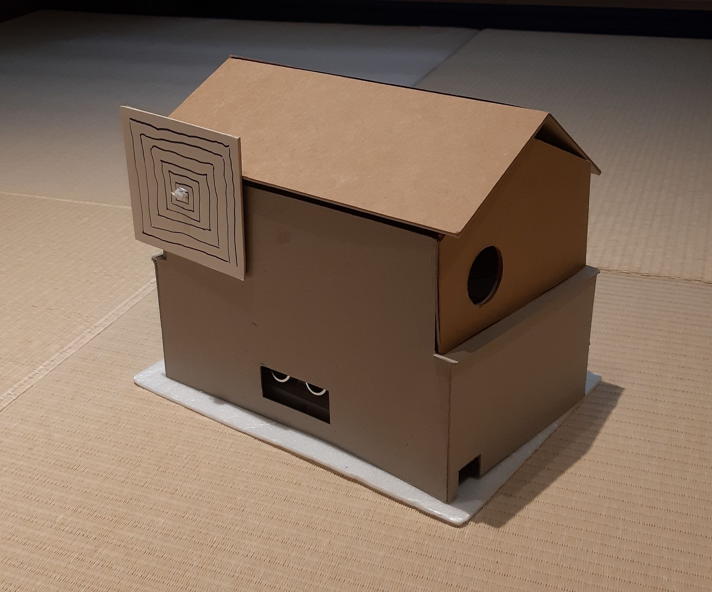

Step 3: The Design of the Model
For this project, the model building is extremely easy, as we only have to create a box with six sides. However, the design had to be as certain as the AutoCAD file, I have provided underneath.
If you really want to make this project well and precise, continue reading to discover the design idea of this project.
This Sound Pulsing Switch contains a box, which has six sides, the holes on the sides each represented a space for placing the electronic components, as to make the device function.
- For the top, there is a hole of length 3 * width 2, for placing the servo motor, giving it space to function and hit the button;
- Next as the opposite bottom, we note that this is just a rectangle base, that contains no holes to hold everything in it nice and confirm; then for the right side, we need a hole for the external power supply wire to come out for connecting to the power bank in order to power the power bank;
- Afterwards, for the left-hand side, it looks identical to right left-hand side but without the hole;
- Lastly, for the front, we need actually more holes, one for the 9V battery connector to be out of the box, so that we can change the battery easily when we go out of power, as to switch off the switch to prevent any waste of battery power, the other is for the microphone of the KY-037, to ensure that the device could detect the change of the sound in the environment;
- Also as the bottom, the backside contains no holes, just to hold everything nice and affirm
Step 4: Building the Model
After we had made our plan thoroughly, we now will have to move onto the process of actually building up the model. However, this process will be extraordinarily easy compared to the previous step, as just do this:
- Cut out the six sides in the scale provided in the AutoCAD file with the cardboard or use laser cut
- Take the tacky glue and paste it on the sides of the pieces to assemble them together, but still leave the backside out that we could still arrange the components within it
- Stuck your 9V battery connector into the hole that we have cut in the front side of the model
- Stuck your KY-037 Sound Detector Sensor Module into the hole that we have cut, but remember to cut a little wider, the diameter I provided is an approximate value for "my" component, which might vary in different ones, also the rectangular part might hit the side, causing it not to be tucked well enough, be in mind
- Tear off the sticker behind your breadboard and stick it behind the front piece of your model
- Place your servo motor well into the hole that we had cut out on the top of the model
- Try to place some of the sticky clay behind the servo motor against the side to strengthen it
- Also, remember to put the double-sided tape to make it stronger
- Pull your external USB cable out of the hole we had cut out on the right-hand side of the structure, and connect it to the power bank
- Glue your backside onto the model, but if you are not certain about your work and might still need to arrange or repair your device, use some of the Scotch tapes to stick it first, that you could easily tear it off
