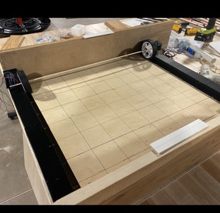

When building the Automatic Chessboard a 26" by 26" board is needed for the base. On top of the center of the base goes a 24" by 24" wooden board labeled by drawing squares in a repeated pattern horizontally and vertically with an area of 9" per square (3" length 3" width). The wooden board can be glued directly in the middle of the 26" by 26" board. On top of the 26" by 26" wooden base at its sides, the 10" by 4.5" planks can be screwed, or glued in so that it stays on the base.
The two 10" by 4.5" planks will be at the side of the base as in the pictures (Note: due to circumstances our team was not able to access planks following these dimensions). These planks will only be 10" in length so that the stepper motors on the X-axis may move around the board as the Y-axis moves (using the wheels) freely.

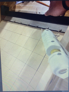

Now with the base setup completely, 3D print the Onshape file named Chess p1, p2, p3 provided in the supplies step twice. These 3D prints will be stationed 3/4 an inch away from the middle wooden board (measuring 24" by 24") adjacent to the 10" by 4.5" standing planks used to hold up the second board.
(On the Onshape document one will see Chess p1, Chess p2, and Chess p3. You must print Chess p1x4, Chess p2x1, and Chess p3x1 to comply with this Instructable. After doing so it is recommended to hot glue the 3D prints together through the male end of each Chess p1 and p3. You should make sure to keep the print perfectly straight when connecting with glue) (If needed the viewer may drill the female ends of Chess p1 and p2 if the female end serves too small).

Now that the base is done continue by 3D printing out the Wheel chess Onshape file listed on the supplies step. These 3D printed wheels will be connected to the 1109 series goRAIL, but first, the REX shaft must be cut exactly two inches using special equipment (our team used a Hacksaw). Finally, the REX shaft is cut position the 1109 Series goRAIL inside of it then connect the side of the 3D printed wheel with the hexagon shape to the 1109 Series goRAIL on both sides.

  • Now that the wheel, axle, and shaft have been made place it in between both Chess p1, p2, p3 3D prints. On top of both sides of the 3D print Chess p1, p2, p3's place a stepper motor. Position the shafts of each stepper motor into the circular part of the wheels (make sure that the CNC shield connected to both motors is currently placed under the wheel, axle, and shaft.)
  • Now place the Caster Rubber 1-1/2" Rigid Wheel adjacent to the most left side of the 2106 Series Stainless Steel REX Shaft and hot glue the platform of the Caster Rubber Rigid wheel to the REX Shaft so that the Rubber Rigid wheel stays up straight and able to roll with the wheel, axle, and shaft system.
  • Hot glue and place the third and last stepper motor on the Caster Rubber Rigid wheel's platform so that the stepper motor stands up straight and balanced (make sure that this stepper motor is also connected to the CNC shield in the same fashion as mentioned in the Arduino Assembly stage. Repeat this step to the opposite side of the REX shaft. (These steppers will be used to move the electromagnet across the X-axis).

  • Place the painted chessboard with the Arduino on top of the Planks so that the board fits in between the wheels of the wheel, axle, and shaft system. Place the Metal weighted Chess Pieces evenly on to their respective squares
The mechanics are now finalized and coding can be done.
