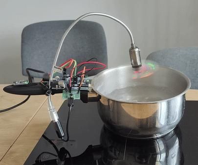

Step 1: Setup
First, we need to connect the microphone to the Arduino board.
Use jumper wires to connect:
  • OUT (mic) to A0 (board)
  • GND to one of the GND on the board
  • VCC to 3.3v
Make sure that you have a USB data cable connecting the board to the pc.
In Arduino IDE:
Make sure you selected the right COM port: Tools > Port and select the right one.
Select the right board:
  • Tools > Boards > Arduino Renesas UNO R4 boards > Arduino UNO R4 WIFI
  • If you don't find it, click on Tools > Boards > Boards Manager..., look for the UNO R4 and install the package

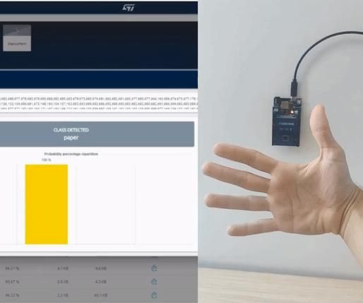

OPTIONAL:
Go to the EMULATOR STEP to make sure your model is working:
  1. Click INIATILIZE EMULATOR
  2. Click on SERIAL (USB)
  3. Click on START/STOP while playing a song
What you see on the up right is the probability to be of each class. If your model works, the highest probability should be the one corresponding to the song that you are playing. It may alternate a bit with other class at some times.
On the bottom right is just a count of the classes that were detected (the maximum probability in the up right is selected as the detected class).
Then go to the COMPILATION STEP:
Click compile, fill the little form and save your AI library (.zip).
In the next step, we will add this library into Arduino IDE to classify song directly on the board.
