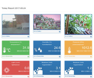

This project aims to create a single controller that automate and control most of the aspects relevant to plants growing. It features control of Temperature, Humidity, Light, Irrigation, Ventilation. The Software is Open Source and the Hardware is based on Raspberry. The system can be connected to internet and be reached using its web interface.
Unlike several other systems based on micro-controllers, the Hydrosys4 does not require any programming skills to be implemented, it is designed to be quite general purpose with a nice web interface.

The Raspberry PI does not require to be connected to a monitor, it is only required to have a PC or smartphone that can connect to a WIFI network, this is because the system will generate its own WIFI network (in AP mode). After initial setup the System can be configured to connect to the home wifi network.

With the Graphical interface, Configuring the system should be just a matter of seconds and experience.
You can check the below video to have an idea:

I'm currently using the Controller for my mini-greenhouse.
The Features implemented so far are:
1) Temperature control using Fan and automatic control of the window via a stepper motor
2) Irrigation based on Moisture Sensors feedback
3) Light control based on the Light sensor feedback
4) Water Spray using the feedback from Air Humidity
5) Liquid fertilizer dosing
Whatever is your setup, a simple irrigation or a more complicated scenario, hope you can enjoy using this system.
