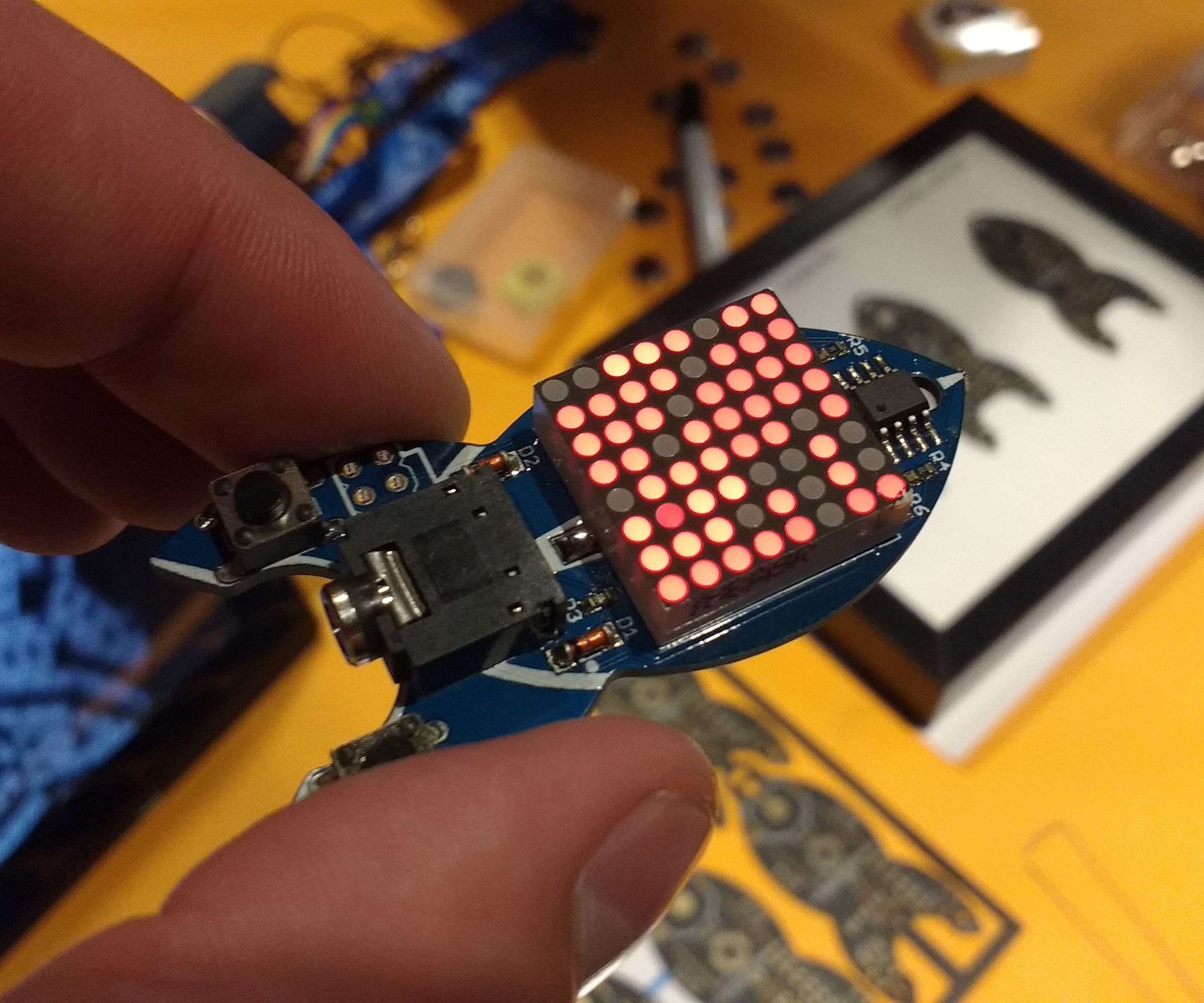

Introduction: BLINKENROCKET - Soldering Tutorial
The Blinkenrocket is a DIY electronics kit
It is made to teach SMD soldering, while providing a fun and useful product that is easy to use.
It features an 8x8 LED matrix that can be programmed using a regular HEADPHONE jack directly on your Laptop, Phone or Tablet.
No APP, No Special Cables, No programmer needed.

Help, please
I soldered everything together an turned the rocket on:
it blinks and shows the text: "V2.1 blinken rocked...." :)
the i startet the webeditor at:
http://blinkenrocket.de/webedit-react/
added a text an connected the Rocket to my Phone/Laptop turned up
the volume an hit the "Transfer-button" but nothing hapens :(
if i unplug the Rocket i hear the sounds out of the Phone/Laptop (like my old Modem)...
doublechecked the Soldering on the audio-jack but don't see a Problem...
Thanks for any sugestion
Reply 4 years ago
Hi Gog,
Some people experienced this kind of problem.
For some taking out the battery and inserting it again worked out.
Others needed to actually turn DOWN the volume as it was overamplified by their soundcard.
Others had problems on iOS/Safari (we are working on this)
One guy found out he had to turn on the volume AFTER pressing the transfer button on his Android-Tablet.
One guy had the DIODES soldered in the wrong way. (see step #7)
On one laptop the adaptor for the audiojack did not sit well in the socket and no audio signal was transfered to the rocket.
That was a hard one to debug, you need an oszi for that.
And than we had a strange one at the 34c3 that worked 50% of the time.
I still dont know what this was about :/
If nothing works out for you send me an email and i will send you a fully assembled and tested replacement for free. (info@blinkenrocket.de)
Reply 4 years ago
Please check out Step 7.
Did you solder the two diodes in the right way?
The webinterface is still work in progress, try to reload and clear your cache.
If it is not working at all please contact me via email (info@blinkenrocket.de) so we can arrange a replacement.
