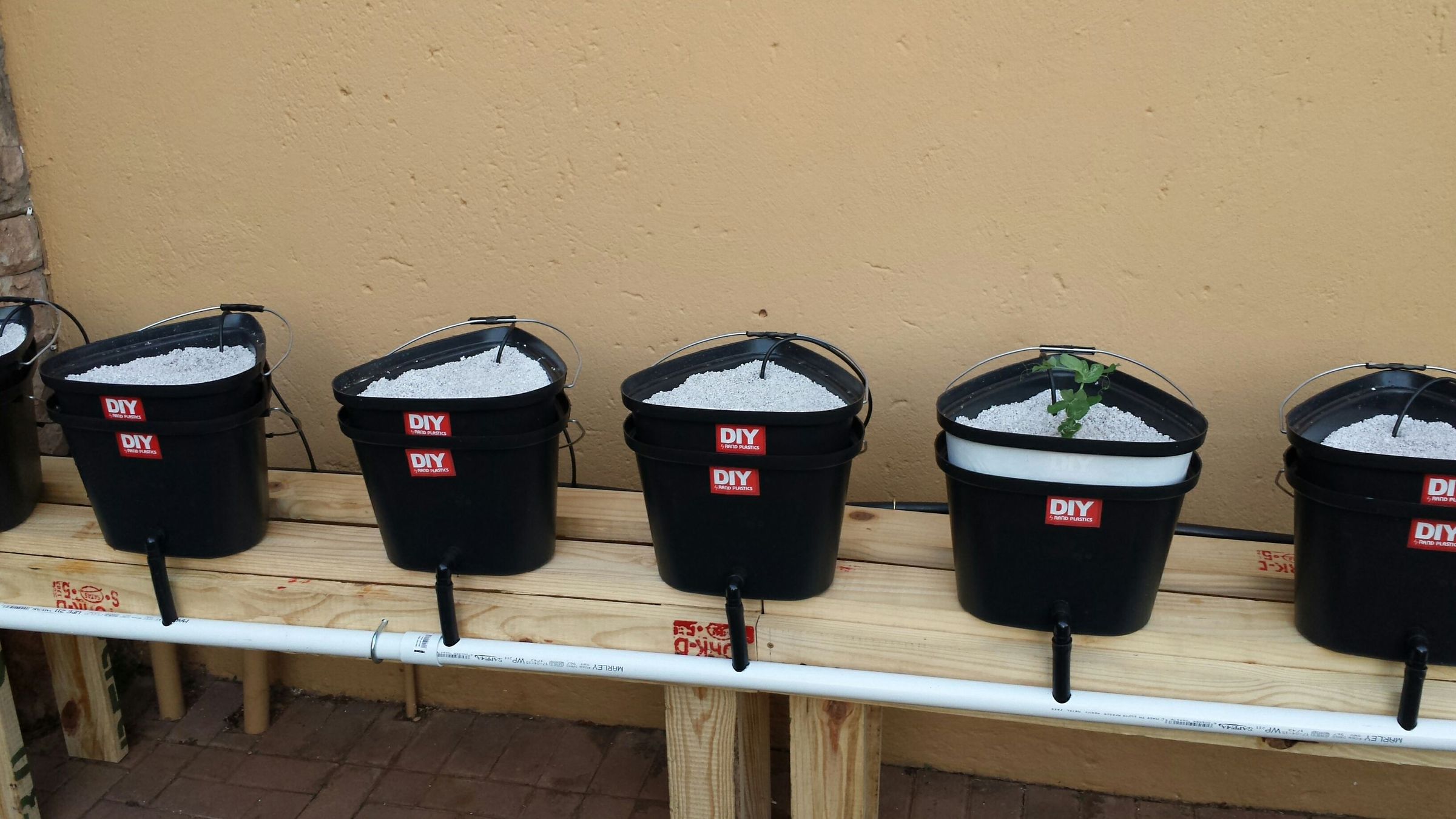

The final step was to add the grow medium. I chose to use expanded clay, or hydroton. Then plug the pump into a timer and set the timer for how many times a day it needs to water the hydroponics.
I'm also not going to go into detail about nutrients used as there is a lot of info on the Web about hydroponic nutrients.
Mine is set to flood 5 times a day, and I currently have seedlings in the system. See the pictures above.
I am still very much learning so I don't know how well the system will work and what problems I will have. I will keep this instructable up to date as time passes.

Step 9: October 2015 Update
Due to persistent algae growth, I have had to make a few changes. I was getting worried that my plants weren't getting enough oxygen so had a bit of a rethink.
What ended up changing was that I changed the white bucket out for a darker coloured bucket that allowed less light through. I also covered the clear PVC pipes with black irrigation tubing, allowing no light to penetrate. Where there were still gaps I covered with black Duct Tape.
