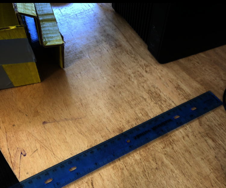

To measure..
-Tape measure (or whatever you prefer to measure with)
