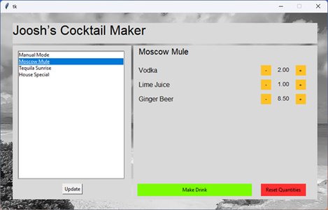

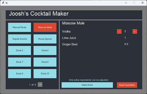

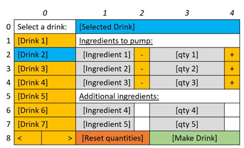

The next step for the project was to create a GUI that would easily show the different drink recipes available. This part of the project probably took the longest since I kept putting off figuring out how to write a GUI. I chose Python as the base code due to its simplicity and ability to run different libraries, specifically a GUI library named tkinter. There is plenty of documentation and examples of how to create a GUI using tkinter, but I had a general idea of how I wanted the interface to look and mocked this up for easy reference (see the first image).
The biggest hurdle was trying to figure out how to achieve this look, and luckily I found a great tutorial (https://www.youtube.com/watch?v=Qd-jJjduWeQ&ab_channel=ParthJadhav) on how to use Figma to visually create an interface and then a custom program to convert this visual design into Python code. I used the code generated as a starting point, then modified it heavily to add buttons where needed. Specifically, I made updates so buttons would only be displayed for ingredients that were loaded based on what the recipe required. Additional functionality such as increasing and decreasing quantities of each ingredient via buttons was also added. This code was tied back in with the previously written code so ingredients of the specified quantities would be pumped when the user selected the make drink button. I kept playing around with different tkinter functions until I found a color scheme and layout I liked.

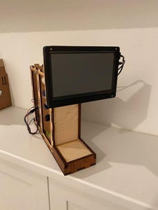

With the code out of the way I next had to figure out how to house everything together into a single unit that wouldn’t look too out of place in our kitchen. I used other kitchen appliances as inspiration, specifically coffee makers, until I came up with a design I liked. This took several iterations, but I finally came up with an idea that hid all the ingredient bottles and electronics. Here's a description of different designs I iterated through when figuring out the housing:
  1. Small enclosure only hold electronics and would pump ingredients directly out of bottles (first few images). I wasn't a big fan of this since it looked out of place on the counter and didn't seem aesthetically pleasing to me. I also wanted to transfer ingredients into another container rather than pump out of what they come in. Good for a quick prototype to get everything setup and confirm the coding works first though.
  2. Pumps located below the bottles (not shown). The issue I found here was it was hard to troubleshoot the pumps if they didn't work. The pumps were then moved to their current position in the bottle cavity where the wiring and tubing is easily accessible.
  3. Bottles upside down for easy loading (not shown). The issue I found here was the bottles were hard to load in place and would leak pretty easily. The bottles were flipped right side up so they could be loaded without leaking.
The images in this step show some of these old iterations along with the latest iteration for reference. I had designed the enclosure pieces to be cut out using my CO2 laser, however if you're following along you should be able to follow the previous step to make an enclosure using simple woodworking tools. Make sure to not permanently attach components on the first try as you may need to take things apart and make modifications while building. I recommend using screws to start.
