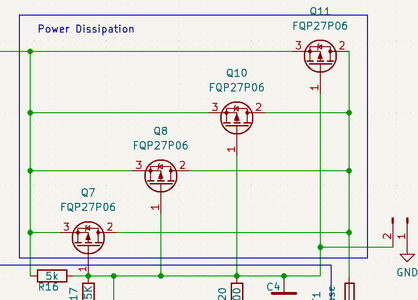

Power Dissipation
Falstad model
The second image shows a set of 4 P-Channel MOSFETs connected in parallel. More or less could also work. As mentioned previously, the unit I actually built uses a single high-power FET instead.
In most applications, FETs are used as switches by setting the Vgs voltage as high or low as practical. In this application, Vgs is run in a middle setting, which limits current and creates power loss as heat - exactly what is needed for this application. This FQP27P06 datasheet graph (third image) shows how changing Vgs limits the current for that transistor. The falstad link above will let you try it yourself.

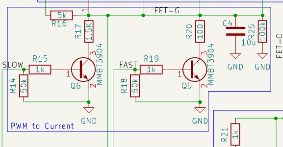

To achieve the target Vgs for the FETs, the subcircuit shown in the 4th image is used.
The main element here is a 10uF capacitor on the right side of the subcircuit. The voltage across this capacitor is the gate voltage that each FET will see.
Filling the capacitor is a 5k resistor, R16. When the capacitor is sufficiently charged (in about 50-100ms), the FETs will be turned off.
The two BJT transistors (Q6, Q9) are used to drain the capacitor. The one on the left is a "slow" drain and the one on the right is a "fast" drain. The size of the resistors (R17 and R20) determines the drain speed. A microcontroller feeds in a PWM signal to open/close these transistors. The duty cycle of this PWM signal determines how much current is pulled on average and the frequency of this PWM signal determines how smooth/stable the voltage will be.
The reason for two drains (verses one) is to support a larger voltage range. At lower voltages (4V), the FAST drain circuit is needed to get the Vgs lower than the SLOW drain can achieve. For higher voltages (25V), the SLOW drain provides better control resolution. Depending on the FET you go with and voltage range you want to support, a single drain may work fine.
In the power-on event, we can assume that SLOW and FAST are initially not driven at all (high Z). In this state the two 50k pulldown resistors (R14, R18) turn off Q6 and Q9 which leads to the FETs naturally turning off (safety feature).
The 100K pull down resistor (R25) slowly drains the capacitor so that it at a known voltage (0V) when the unit is unplugged and idle.

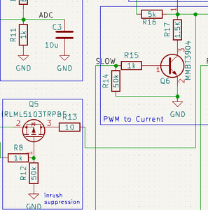

Inrush protection
Falstad model
The 5th image show the inrush protection circuit. On initial battery plug-in, the 100ms or so it takes the capacitor (C4) to charge via R16 could allow a high current to pass through the FETs for that time period. This is mitigated by the following inrush protection circuitry.
The way this subcircuit works is that we have another resistor, R13, which is only 10 ohms. This one has the capability to fill C4 very quickly (in a handful of microseconds). The downside is that it's too fast to leave it open all the time.
Thus we have a FET, Q5, that can turn R13 on and off. On initial plugin Q5 is on (thanks to R8). When the user presses the "ON" button, the same voltages that powers the microcontroller also turns Q5 (and thus R13) off, disabling the circuit.

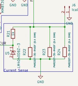

Current Sense
Falstad model
Refer to the first image. One of the four ways the microcontroller decides where to set Vgs is by monitoring the current flowing through three resistors (R22-R24). The other three are voltage, power, and temperature. An ADC within the microcontroller measures the voltage across these resistors then uses Ohm's law (I = V/R) to determine the current.
Resistor values were chosen for a full 3V swing at 30A of current. This choice allows us to use the full 12-bits of ADC resolution for good accuracy. The downside is that 3V * 30A = 90W, which is a lot for a resistor to dissipate. To support this, I chose 3 35W 0.4 ohm resistors connected in parallel for a total dissipation capability of ~100W and an equivalent resistance of 0.133 ohm. Potentially wasting this much power on a current measurement would normally be frowned upon but in this application it's actually helping take some load off the main power FET.
A Zener diode (U5) is used to protect the ADC of the microcontroller in the event that the divided voltage is too high (> 3V). This is a protection feature that serves no function under "normal" operating conditions.

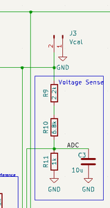

Voltage Sense
Falstad model
Refer to the second image. The microcontroller monitors the overall battery voltage to determine a sag value and to determine when the drain process is completed.
The circuit is a simple voltage divider with a capacitor to help stabilize the reading.
Battery voltage sags while under load. Remove this load and the voltage raises back up. We want to know the "unloaded" voltage so that we know when draining is complete and also so we don't pull too much current. We measure this unloaded voltage by periodically turning off the FETs (for one second every 10 seconds) and measuring the "unloaded" voltage at this point.
The voltage at R9 is not exactly the battery voltage as it has to pass through a a diode and FET. The software provides a calibration value to account for this drop.

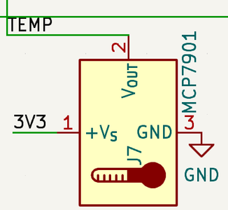

Temperature Sense
Refer to the third image. A temperature sensor is placed against the heatsink and as-close-as-possible to the Power FET to monitor the FET temperature. This measured temperature can be used to control a cooling fan (described below) and reduce the current draw as needed.

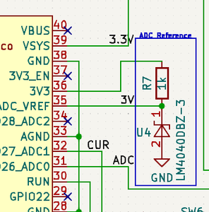

ADC reference
Refer to the forth image. When using a microcontroller-provided ADC, one can typically choose from several different sources for the calibration with the internally-generated 3.3V source as the most convenient. The downside of choosing this source is mediocre accuracy.
This design uses the alternate ADC_VREF input with a LM4040 voltage reference to allow for more accurate measurements.

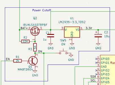

The battery drainer is designed to draw nearly zero power (outside of parasitic losses) after you turn it off or it turns itself off. This is implemented with the following circuit:
The Q2 FET is key. It determines if the microcontroller gets any power. Q2 is off by default, turned off by R2. There are two ways to turn it on:
  1. If the user presses SW5
  2. If the microcontroller activates Q1 via "EN". The microcontroller does this as soon as it can (in a split second) and holds it high until the microcontroller decides that it is time to power down OR the user presses the "OFF" button which forces Q2 off.

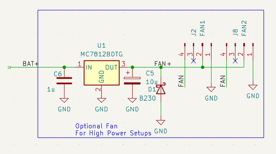

Fan connection
Refer to the second image. This sub circuit supports a PWM-based fan controller.
The circuit is just a 12V linear regulator with supporting capacitors. The connections support "PWM" style PC case fans which are specified to accept a 25Khz PWM signal on pin 4.
A flyback diode is needed when powering generic motors but is unlikely to be needed here as PWM-controlled motors usually already have one in the motor control circuit. You can add one for peace-of-mind if you choose.

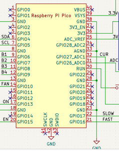

As is typical, a microcontroller orchestrates the operation. Here I chose a PI Pico because it is inexpensive and quite capable. It's main downside is the lack of a low-power sleep mode, but the power cutoff circuit explained above compensates for this shortcoming.
A little bit on the tasks the Pico must attend to:
  1. When the unit is powered-up, the Pico must raise the EN pin to keep the power on
  2. It must lower the EN pin when it is time to shutdown.
  3. It controls the dissipation rate of the main FETs via PWM signals on the SLOW and FAST pins.
  4. It measures current by ADC decoding the voltage at the CUR pin.
  5. It measures the battery voltage via an ADC.
  6. It provides an output display via SDA and SCL
  7. It controls the fan speed via the FAN pin.
  8. It monitors the buttons Select and OK buttons.

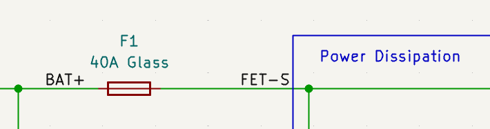

Protection Fuse
We also have a protection fuse to help protect against software bugs or other unexpected problems. More protection would be offered if the fuse were right at the battery input but this would introduce a further temperature-dependent voltage drop that would throw off the voltage measurement. The "unprotected" components are the digital logic which should be low current draw barring a physical issue with the board (< 100 mA)

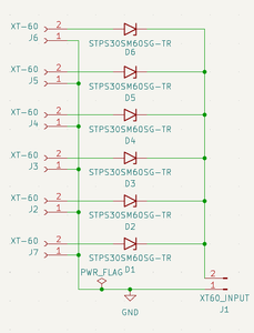

Daughterboard
You could plug a single battery into the unit or use a parallel adapter. Safer than a parallel adapter is a board with integrated protection diodes. This will allow batteries of different charge levels to be plugged in without the concern of large current flows due to unequal discharge levels. The firmware can account for the drop across the diodes after the user calibrates the board.
A bundled example provides connection for 6 XT-60 packs.

For cooling, I ended up going with 2 120x69x36 mm finned alunimum heatsinks which cost me $13 each for a total of $26. These work great but having to use two is a bit inconvenient, due to the vertical seam in the center. I tapped holes in these heatsinks, both for mounting the board and for holding the FETs, resistors, and temperature sensors securely to the heat sink (with the aid of thermal paste to complete the thermal connection).
On the backside of the heatsink, I have a 120mm fan which blows air into the fins. The microcontroller controls fan speed based on current temperature and power dissipation.
