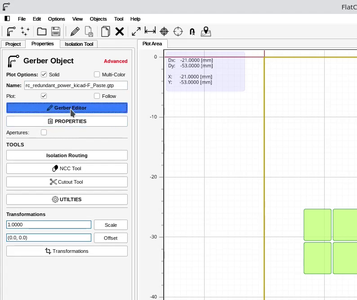

Step 3: Load the Gerber Files Into Flatcam
CNC machines do not directly understand Gerber files (Gerber files lack CNC-specific information, such as how fast and deep to make cuts). You will thus need to use software to convert Gerber to GCode.
As usual, there are many options. Here I will use Flatcam because it is free and can also generate Gcode for etching PCBs (that are not overly complex). I explain how to do this in a separate guide.
As the images show, for Flatcam, you first load your Gerber files in, either just the "F Paste" layer or the "Edge Cuts" later as well if you want a cutout.

Flatcam can not seem to generate cuts inside the "F Paste" traces. If you allow it to produce cuts outside the traces, then the final holes will account for the CNC's bit size in the incorrect way, leading to larger-than-needed holes in the mylar. We are talking around 0.3 to 0.4 mm too large. This might not be a big deal but, if you are like me, you'll still be motivated to correct for the error. Here is a way:
  1. First enter the "Gerber Editor" for the "F Paste" layer and select everything.
  2. Next, click the small "Transformations" icon in the toolbar.
  3. Enter the size of the bit you are using as a negative offset and choose "Buffer B". I go with -0.2mm and it is working well.
  4. Click back on the "Editor" tab at the top, then click "Exit Editor" at the bottom of the tab pane.
Now you'll have a new layer which is a shrunk version of the original. The new layer has the same name as the original with an "_edit" suffix added. The original, untouched layer still exists. In the final image above, the original layer is drawn in light green and the new layer is drawn in blue.
You may opt to delete the original layer from the Flatcam project to avoid accidentally using it.

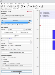

Step 5: Gerber to Geometry
Flatcam uses two middle formats between Gerber and the final GCode called "Geometry" and "CNCJob". In this step, we are going to create the geometry.
To do this, select the "F Paste" layer on the side bar (choose the _edit version if you followed step 4), click the "Properties" tab, and select the "Isolation Routing" option.
The second image above shows the properties I chose.
I'm using the 20 degree V bits that are bundled with most 3018 CNC machines. The UI above has a V-bit calculator that you can use if you want to but, in my view, it's built on the illusionary foundation of excellent precision and tolerances. I always just choose "C1" as a bit and 0.2 as a cutting width and this has been working well.

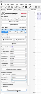

Step 6: Geometry to GCODE
We are now going to take the geometry object created in step 5 and create a CNCJob object. This is done by selecting the geometry object, then clicking the "properties" tab. Now we should have a form similar to the first image.
Filling in the form:
  • Cut depth should be around -0.2mm. Cutting too shallow means that you might not get a clean cut across the design but this is easily mitigated as I will explain later.
  • You can cut relatively quickly. I went with a feedrate of 300mm per minute but I would not be surprised if higher settings work well.
  • Make sure you set the spindle speed appropriately to avoid breaking a bit! For a cheap 3018, the machine has no RPM feedback mechanism. Instead, anything over 1000 sends the maximum available voltage to the motor, which will typically result in a spindle speed around 7500 RPM. Cutting mylar is quite forgiving for settings so I just use 10000 as a setting.
Exporting GCode
The only thing to do here is visually look over the routing paths, then click "Save CNC Code".

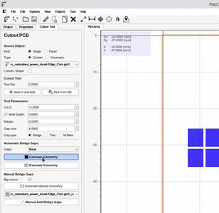

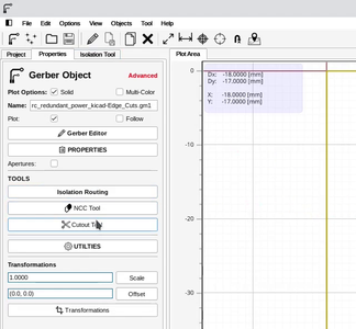

Step 7: [Optional] GCODE for Edge Cuts
If you want to cutout the stencil to be exactly the same size as your PCB, follow these steps. Note that many guides suggest making the mask larger. Using the same size works well for me.
  1. First, select the edge cuts layer and choose "Cutout Tool".
  2. The tool diameter is 0.2mm and the cut depth is -0.2mm.
  3. Bridges is a personal choice. I don't use them because I secure my mylar with double sided tape. If you are clamping down your stock, then bridges will likely be needed.
  4. The CNC settings are essentially a copy of the F Paste layer.
and as with the F Paste layer, you can run a post checker on your GCode for a little extra piece-of-mind.

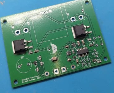

Step 11: Final Results
Here is the final result after hand-soldering the through-hole components and adding an acrylic cover (another thing the CNC machine can assist with!)
